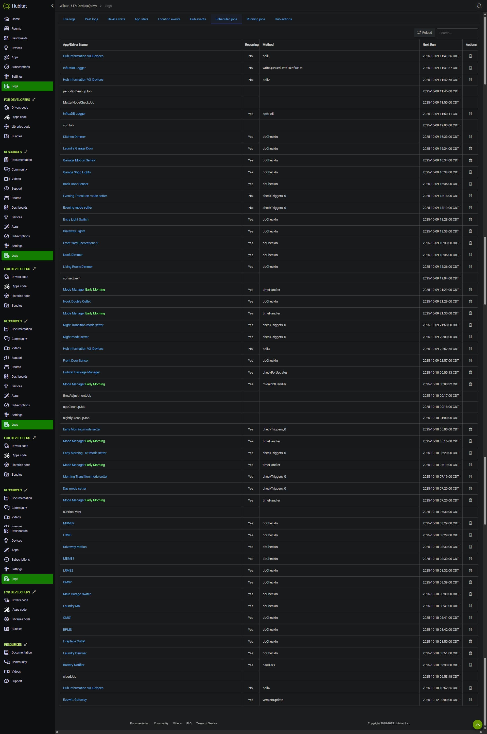

The key way to identify what i was experiencing was to look at the "Scheduled Jobs" tab on the "Logs" page. There were a ton of jobs that got hung up and were not running even though they were scheduled.

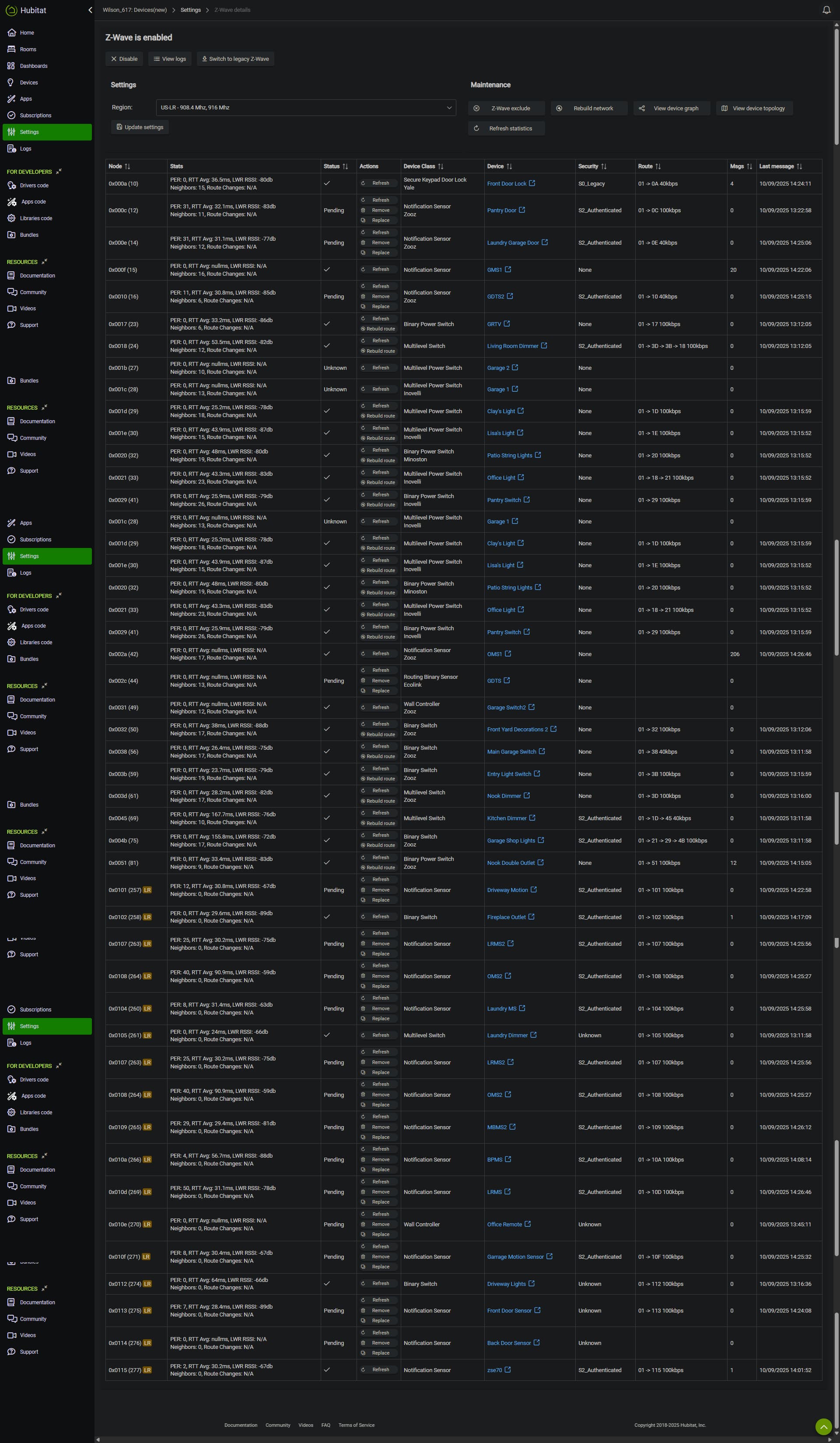

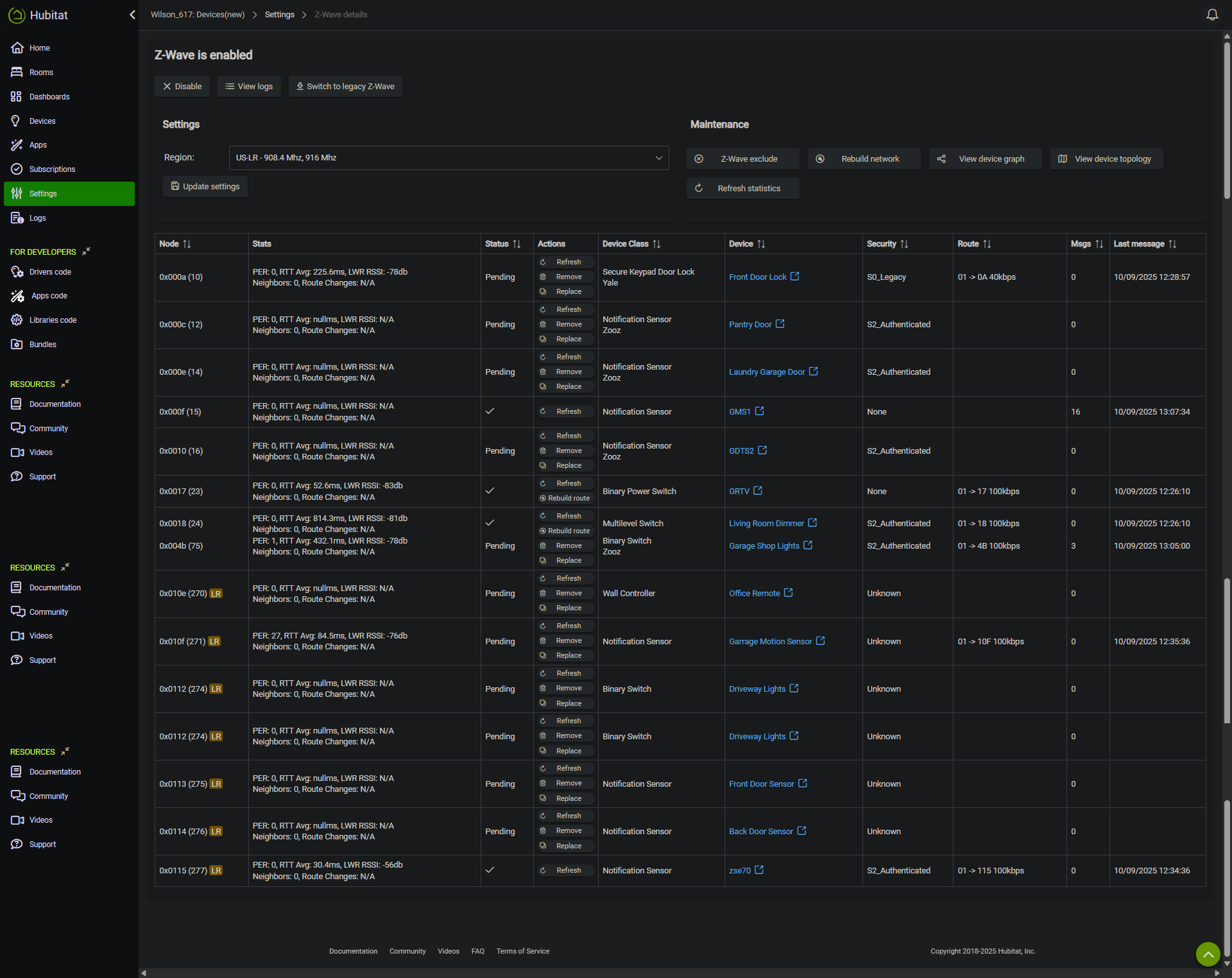

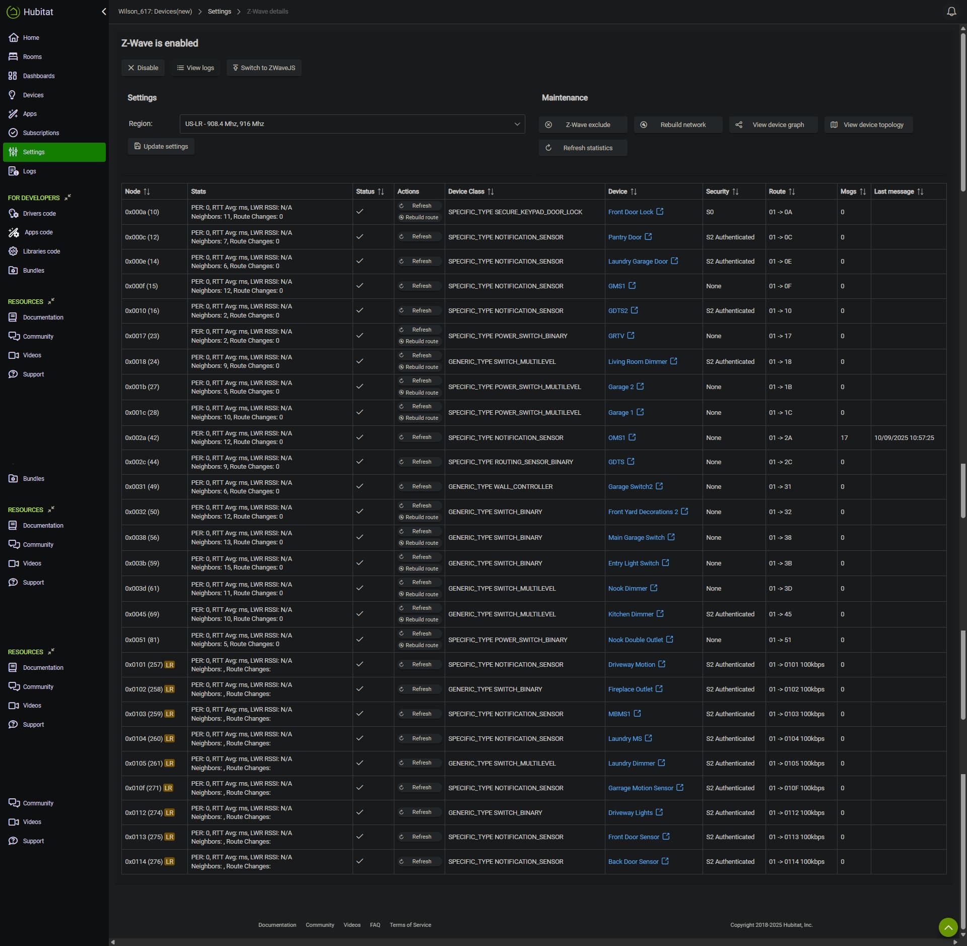

So After migration, still on Zip Gateway, this is what the Zwave Details look like (just started Zwave logingge)

I've done a full reset a few times. Just did one this morning. The zwave devices above are after that) Zwave logs have been blank since. I have NOT yet switched it to ZwaveJS. I guess I could now.

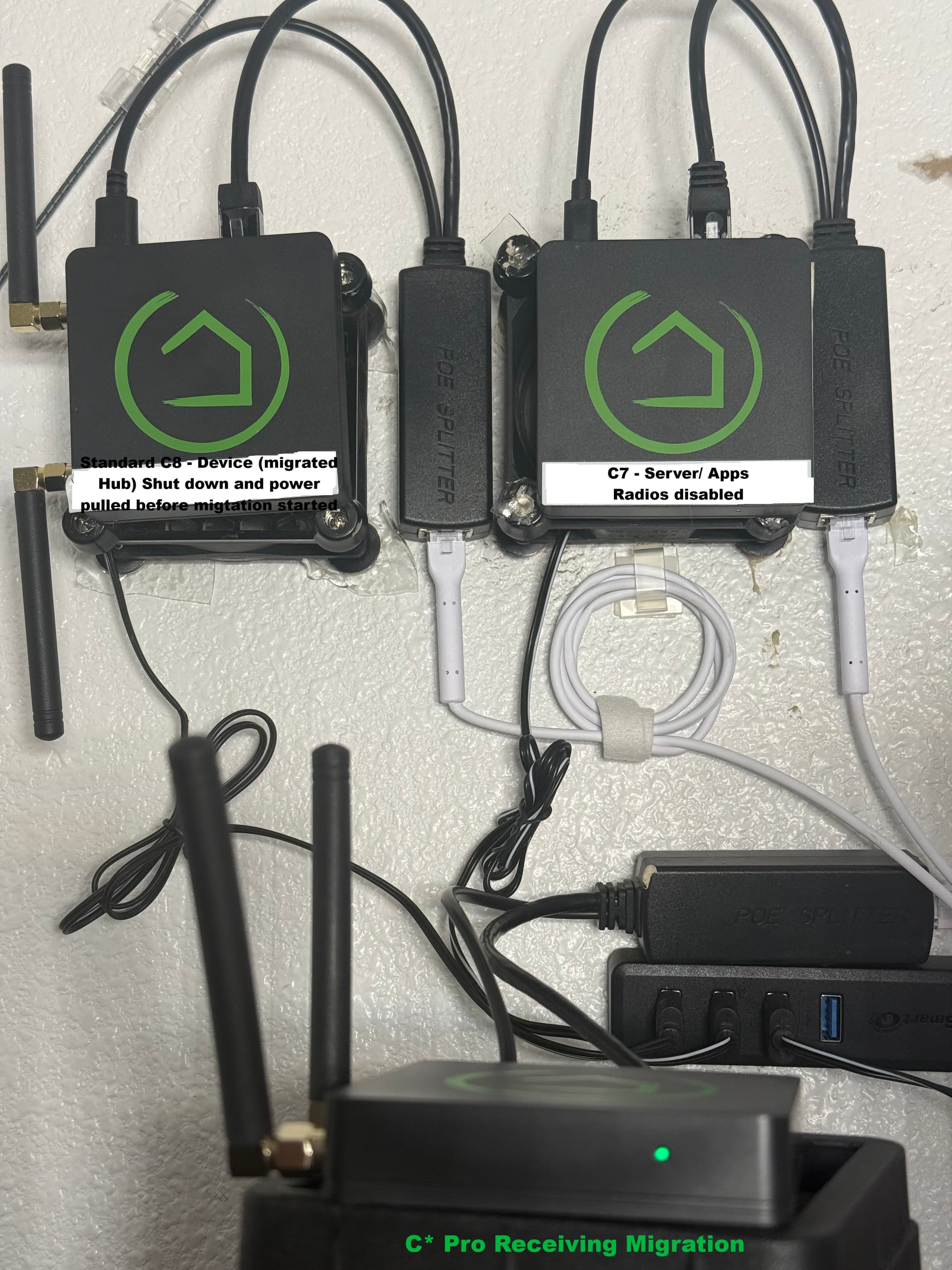

Very Close, actually the C8Pro is in a MORE open space than the standard C8. My hubs have all been wall mounted for at least four years.. I just didnt go the the effort to Mount the Pro until it was up and running. I have gone ahead and pulled the Standard C8 down and put the Pro in its place.

I just noticed that you are powering your C8 Pro through power over ethernet.
There have been lots of problems with various POE units.
I definitely suggest you use the Hubitat supplied power supply when you’re doing your migration and testing.
I just thought of that. Been using POE splitters for years without issue, and these are the ones there said to work better. Working on it. Not an easy change in this location.

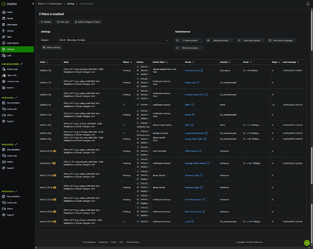

Here are the Zwave details after switcih to ZwaveJS
Looking more promising than it has in a while.

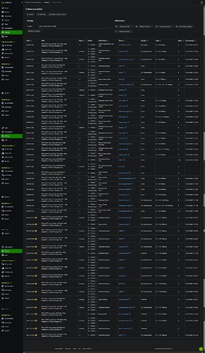

About an hour in from the power switch and this is where it stands. Look like most if not all main powered devices have checked in,in cluding the LR devices that have been problem children this whole time. Now it seems like it s waiting for all the battery powered stuf to wake up from thei nappies and check in . Wich there was an easier way to force that.
