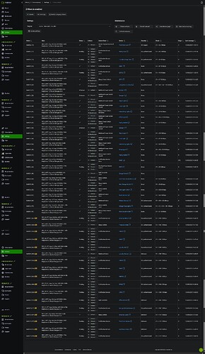

Too soon. Seems llike everything has stalled out,, most motion and contact sensors, including all battary powered LR stuff is still pending. So very few automations workng, anf the frew that are involce matter devices and a very high traffic zwave motion sensor (Under the desk wehre im doing all this).
As noted previously, I believe, they (battery devices) may just take a little longer. The overall table looks good for mains powered devices except maybe on, I think. :crossed_fingers:

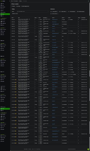

Starting to lean towards another fail . Concerned there still seems to be an issue with Zwave LR devices not checking in . and even the mains devices , while showing a last message, dont seem to be responding

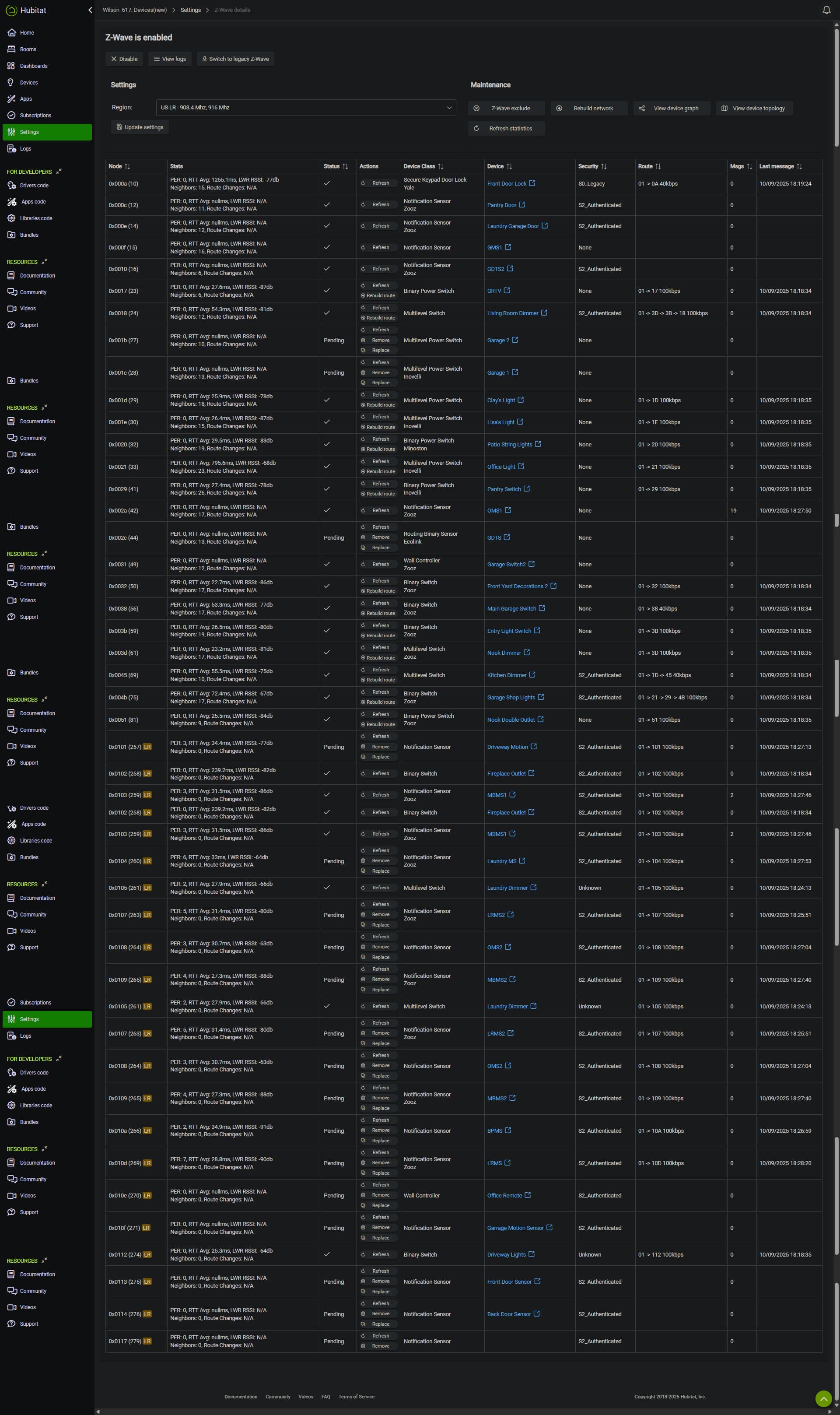

Did you reboot it again since the previous screen shot. It looks like the hub was rebooted as some devices that had last message date and time do not in the most recent screen shot.
When you say it isn't responding do you mean if you initiate a change form the hub it doesn't happen. What happens if you flip the physical switch and it turns on/off. Does the update get back to the hub?

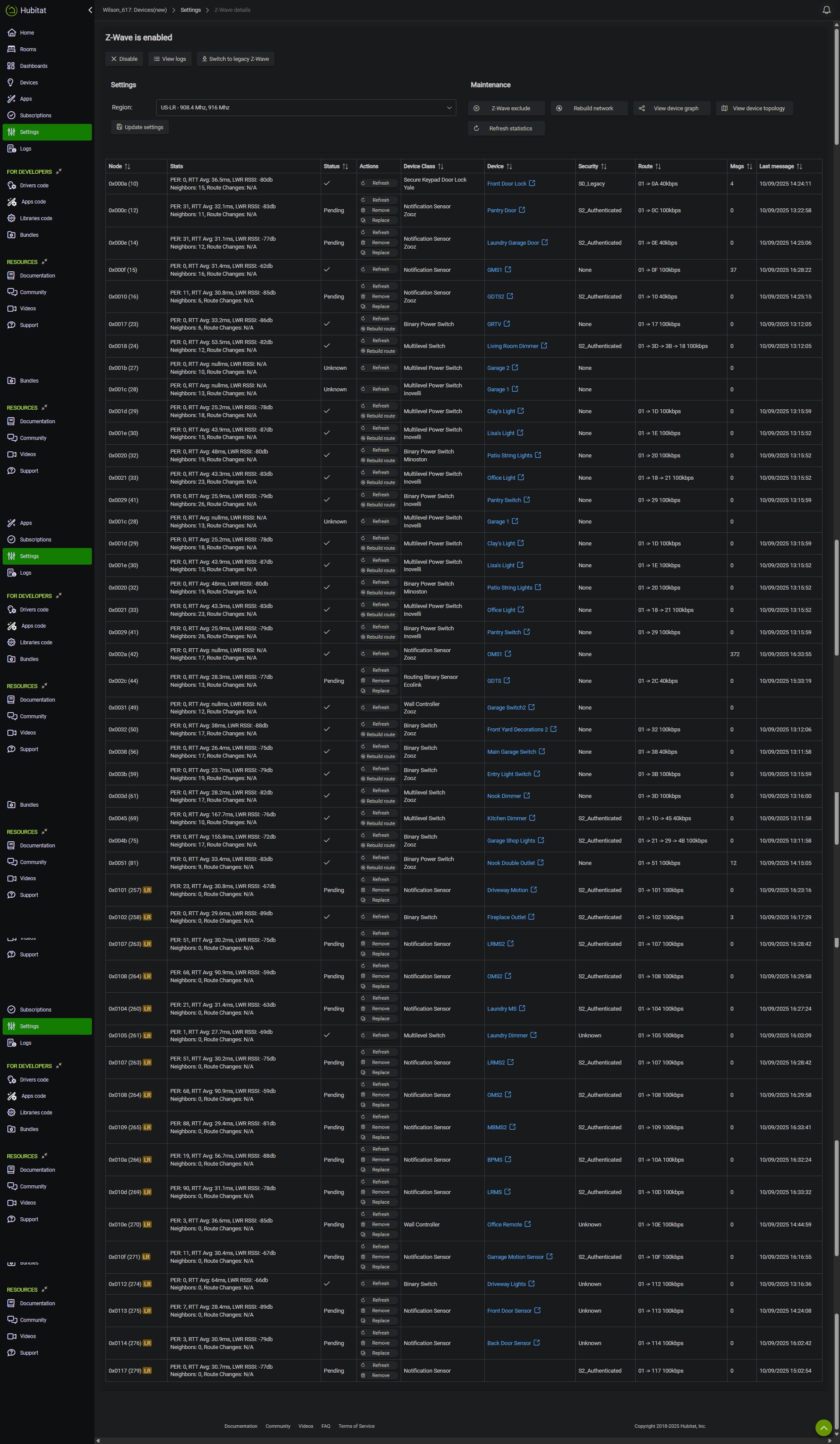

Correct. Plus plenty of motion sensors flashing they they sensed motion (been walking around all afternoon doing stuff) but nothing shows in logs, and the autiomations they are supposed to trigger arent firing off.
on the mains devices, its about 50/50 some it is registering, some its not. battery devices , no. even if they have a check, route and last message.
