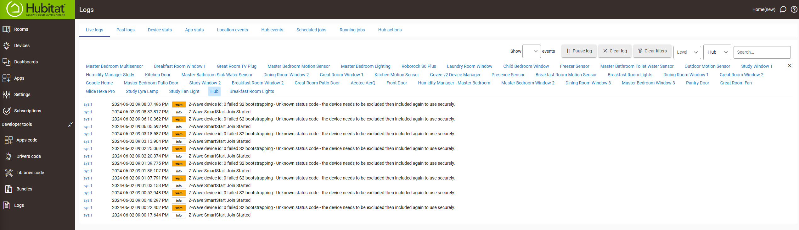

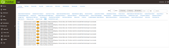

When looking at the logs i see this
Any idea guys

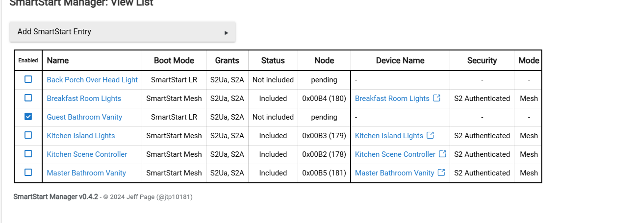

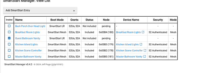

I'm not going to try to step too far into Jeff's territory here, but it may help to have a screenshot of the settings you're using in his SmartStart app.
Here it is. I didn't make any changes when adding the device Smartstart info from the mobile app, and then i don't do anything in this app other then enable and disable. I just disabled them here after they were added. I was just excited about this being a potential backup for all of the Smart Start items in the system

I've been struggling adding LR devices to my C8. I had devices that were originally mesh, that I created virtuals, removed, switched to Smart Start with the LR checked in @jtp10181 's app, and encountered the same type of issues you are describing... I was eventually able to get them added after multiple tries, but routinely got the same:
Z-Wave device id: 0 failed S2 bootstrapping - Unknown status code - the device needs to be excluded then included again to use securely.

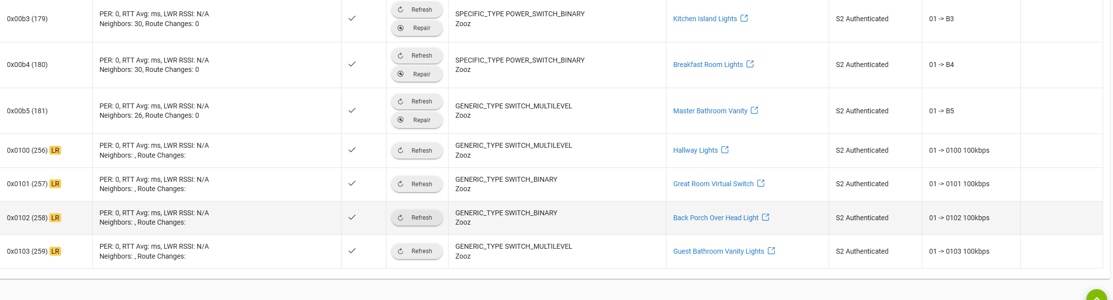

Are you referring to the 4 devices with full details in the screenshot in post #4 above?
Those are paired Mesh, not LR. Or perhaps I'm totally misinterpreting things here - my apologies if so... This whole LR pairing thing is quite the ...errr... adventure in these early days here!
No those 4 devices are Zwave 700 devices and don't support LR. It is the two that are not showing included yet.

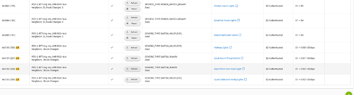

Here are the LR devices as shown on my old C8
