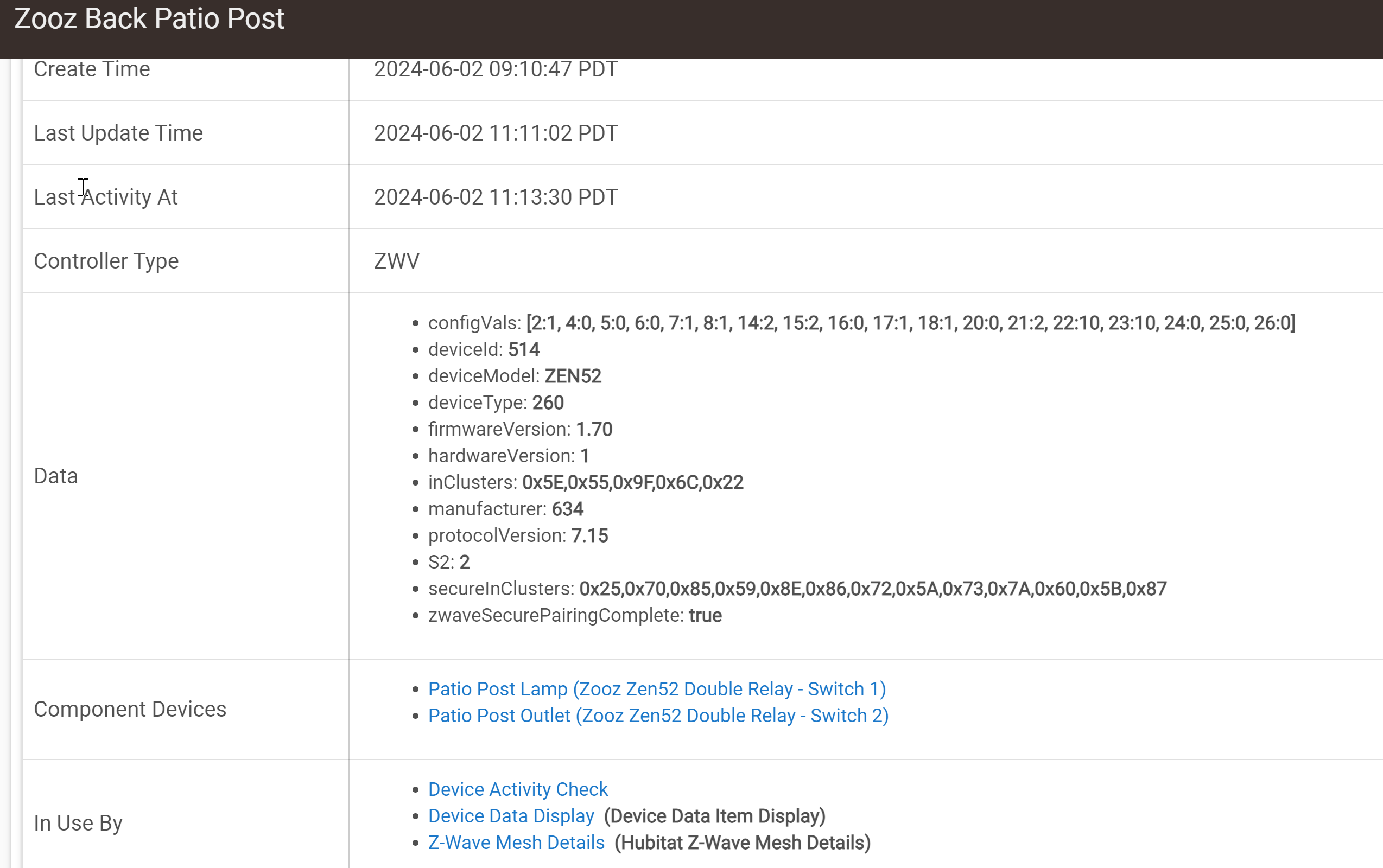

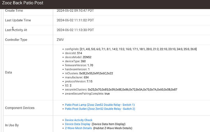

I was able to get the last three zen51/zen52's added to the hub... Everything works, as they have devices and component devices where they should be. I can control them, turning off and on, but, the three entries for them disappeared in my z-wave details!
shutdown, plug pull, did not fix it... they are essentially ghosts, that don't show as ghosts but that the hub's z-wave radio can still control!
Have you seen that before?
even if I pull up your app, they show missing... but they have device details, including z-wave details! just don't show in the z-wave settings...

For the record, after joining, and while I configure it, it DOES show in the z-wave settings page... However, with every shutdown and unplug, when the box boots back up, the devices is missing from the z-wave page... to answer your other question, yes they still work...

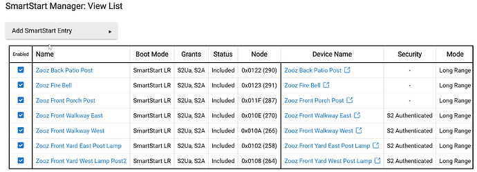

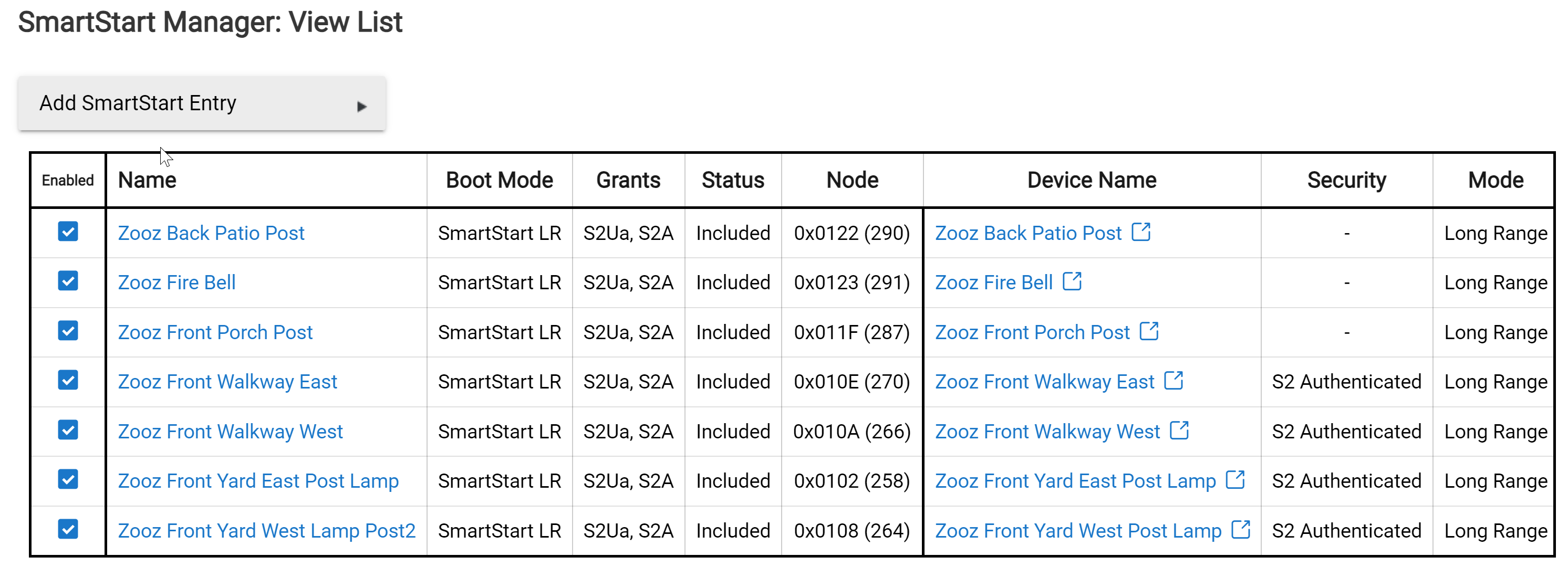

The last device that is showing in details page I added last night and it has a DNI of 0x010E (270) - a ZEN52.
The five missing devices that I all added today are as follows...
0x011F (287) - a ZEN52
0x0122 (290) - a ZEN52
0x0123 (291) - a ZEN51
0x0125 (293) - a ZSE41
0x0128 (296) - a ZSE41
As you can see, there are gaps between those numbers, but I don't show any ghosts... so not sure whats happening there...

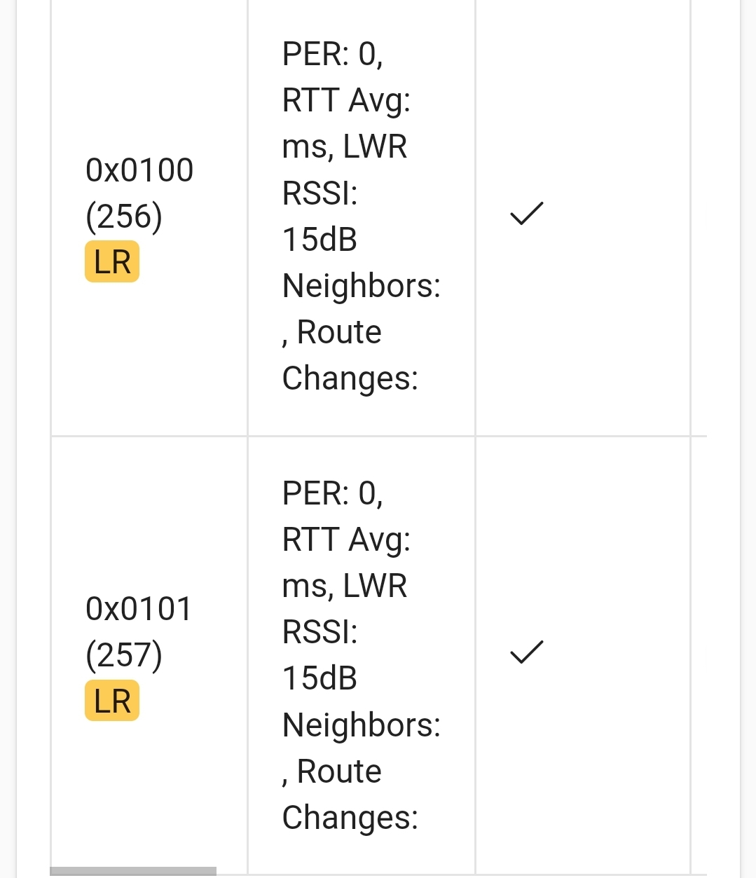

I've only paired two LR devices on my C8-Pro (played around a bit first on a C8). My numbers below FWIW.
