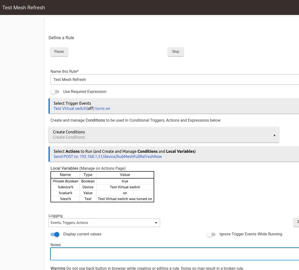

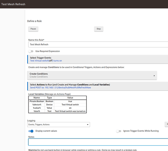

Is there a way to force a Hub Mesh sync/update through a Rule Machine action?
Probably would require an endpoint provided by HE, since Hub Mesh isn't an app/device you can call from RM (at least not as far as I can tell).
This should be it from my notes:
hub-ip-address/device/hubMeshFullRefreshNow
Not sure if you can use that via RM, though.
Do you know how I can see the response (to see if it works)?
When I do that in a browser, I get the response "ok".
How do I see the response in RM?
(logging doesn't do it...)
Yeah, I'm not sure if that's possible (getting the browser response), and if it is I'm certainly not the guy to tell you how. :wink: Sorry, above my pay grade.
Were you able to make it run from within a rule? Wasn't sure how to do that either. (Boy, am I helpful...not.)
