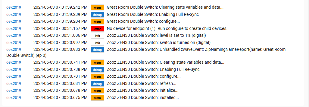

Earlier this morning I wiped the radio and have reloaded everything. Now the only problem i have is the Zooz Zen30 Double switches aren't generating their child device for some reason. The LR devices all added fine after the radio was reset. Well i also have one Ring Contact sensor that just refuses to add back to the hub. No idea why. but so far it hasn't been to bad
Here is the error that the device is getting when it is trying to add. Looks like the device is trying to add, but then failes in some fashion.
The Zen30's are zwave 700 series.
Do you have the most current ZEN30 driver? I would need to see more of the configure output.

Start of the configure should look something like this:
I removed and added those double switches back multiple times in different ways (classic with and without S2 Encryption, and with Smartstart) and it was a no go. The line about the Unhandled zwaveEvent: ZipNamaingNameReport got me worried there maybe another corruption issue. All I ever got was what was shown above. The last 3 lines were all I would get once I clicked on configure. It would get to that point and just get stuck. Late yesterday i wiped the radio again as a troubleshooting step and got the same result.
I finally got them to add with their child device for the relay by removing the community Zen30 Driver and letting the add take place with the built in driver for it. Once I did that the 3 double switches I have added right the first time.
One thing that was strange is I saw what looked like 5-6 scheduled jobs on the device page when scrolling to the bottom. They would just show pending status because they seemed to have a time in the past. Not sure what that was about I suspect some part of the set process was getting stuck in those jobs.

That’s normal, it’s due to the smart start coping the same I guess, not sure why it creates a zwave event.
