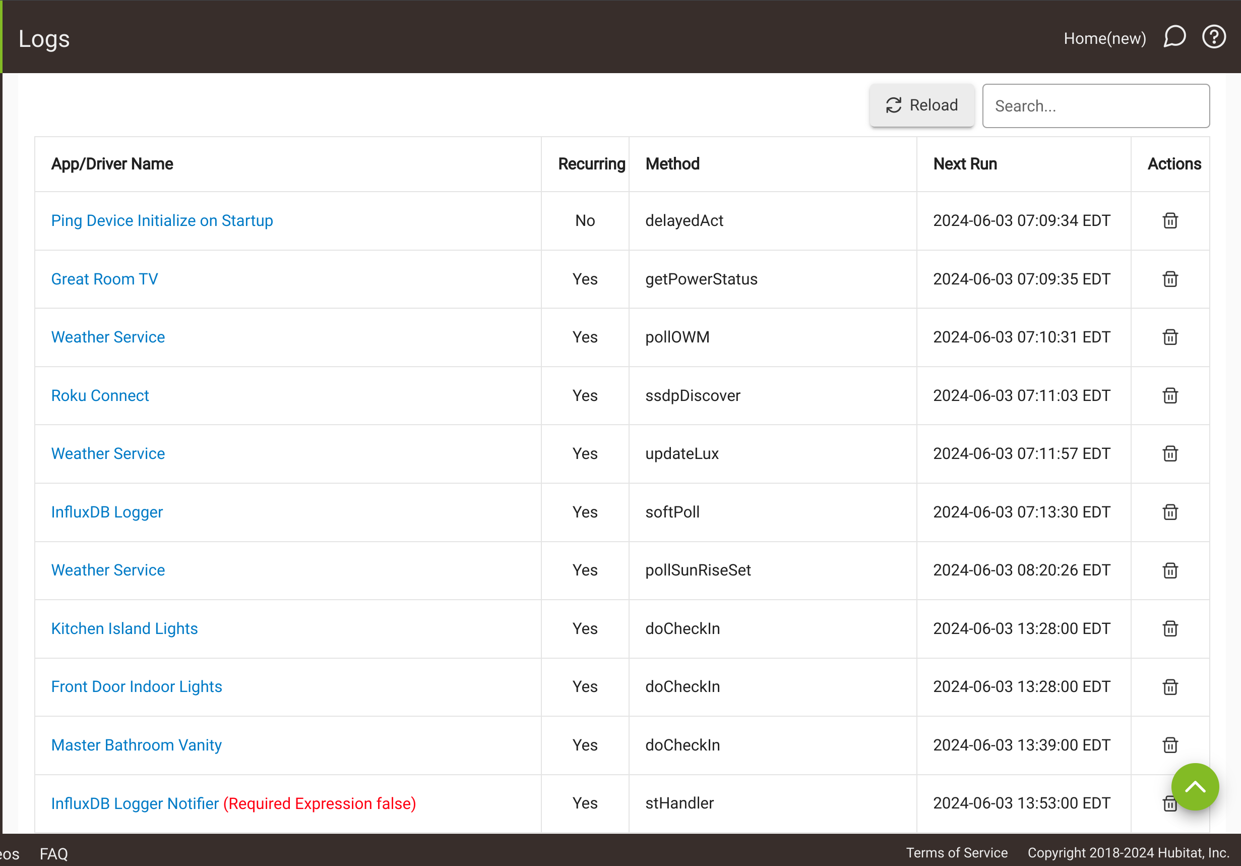

What is really throwing me off is that when I do a restore from the migration cloud backup I am getting a bunch of jobs that are in the past. Like days back from when the migration backup was likely taken.
I just did a restore from the last Migration backup I took. After restoring with that backup i have these jobs listed

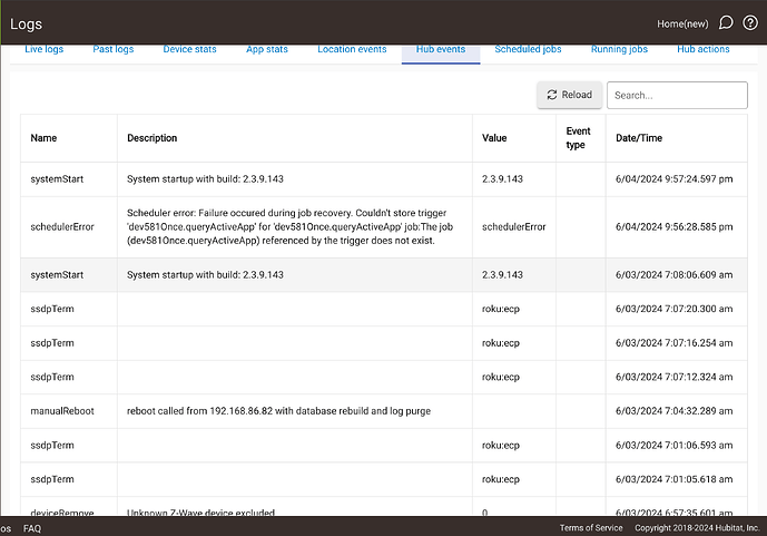

I also just noticed this error with the scheduler..
I am fairly certain i saw something similar with the previous backup as well so i think this has persisted through multiple back jobs while working this.

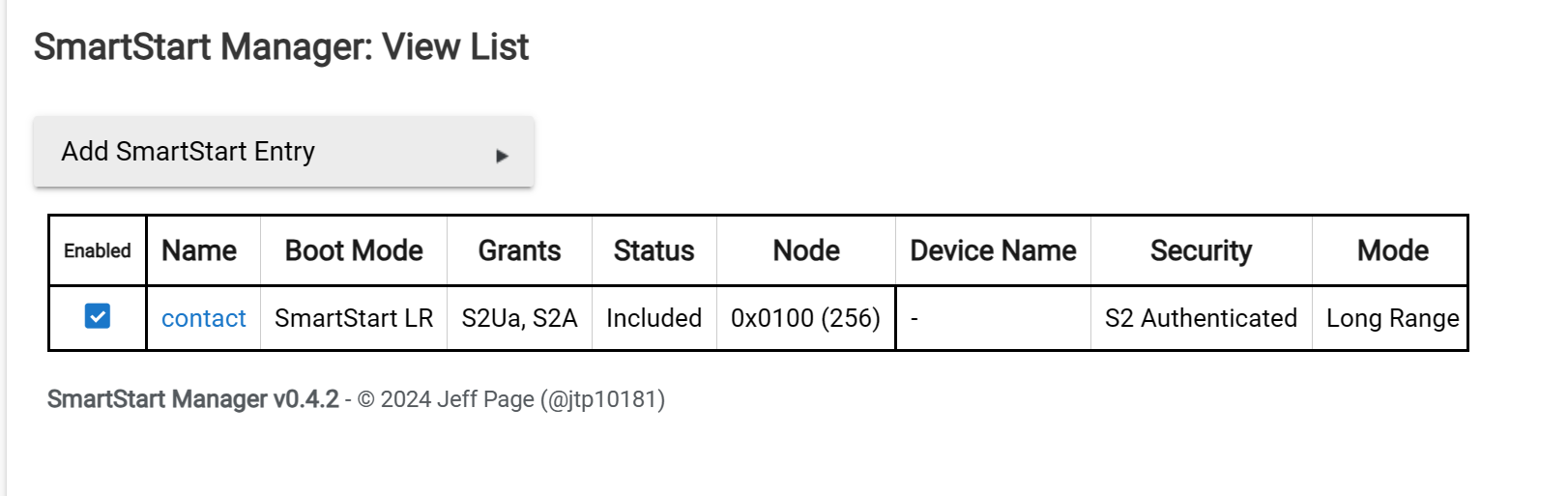

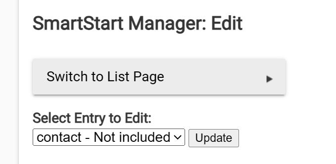

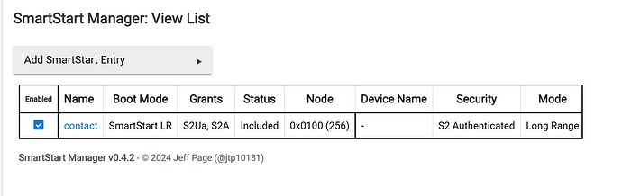

Interesting discrepancy: If I go to edit the SmartStart entry, this is what it shows.
I'm not sure if it is, or is not included. My bet is it is not included.

  2. The backup was having some kind of issues with the scheduler that wasn't obvious and didn't cause a complete failure. (The second restore to a older local backup was for this)
