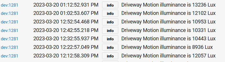

Well, I'm back to every 10 minutes for lux reporting.
This is with no motion.
Temperature reports are more frequent, because dropping from being brought outside.
Let's see how long it stays connected, lol.

Outdoor Hue motion still running in the outdoors. 6.5 hours.
Reporting lux every 5 minutes, lol.

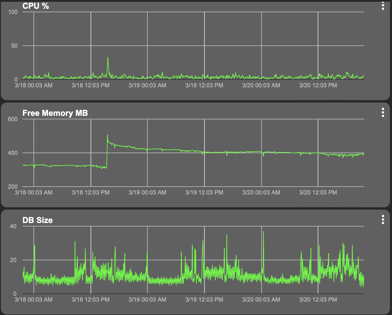

At 9:00 PM my zigbee radio went off, and then came back on approximately 1 minute later. This is the second time this has happened.
Strangely enough, my Hue Outdoor Motion Sensor appears to be still connected and reporting in every 15 minutes or so. All other devices appear to be OK also.
I never saw this happen with my C-5. I'm not sure whether to worry about it or not. I've seen a few other reports of this, but can't recall seeing anything "official."
Does anyone know to capture the zigbee or z-wave radio turning off via RM?
I'm not seeing anything weird in the stats. The big spike in CPU% and Free Memory was the last upgrade.
