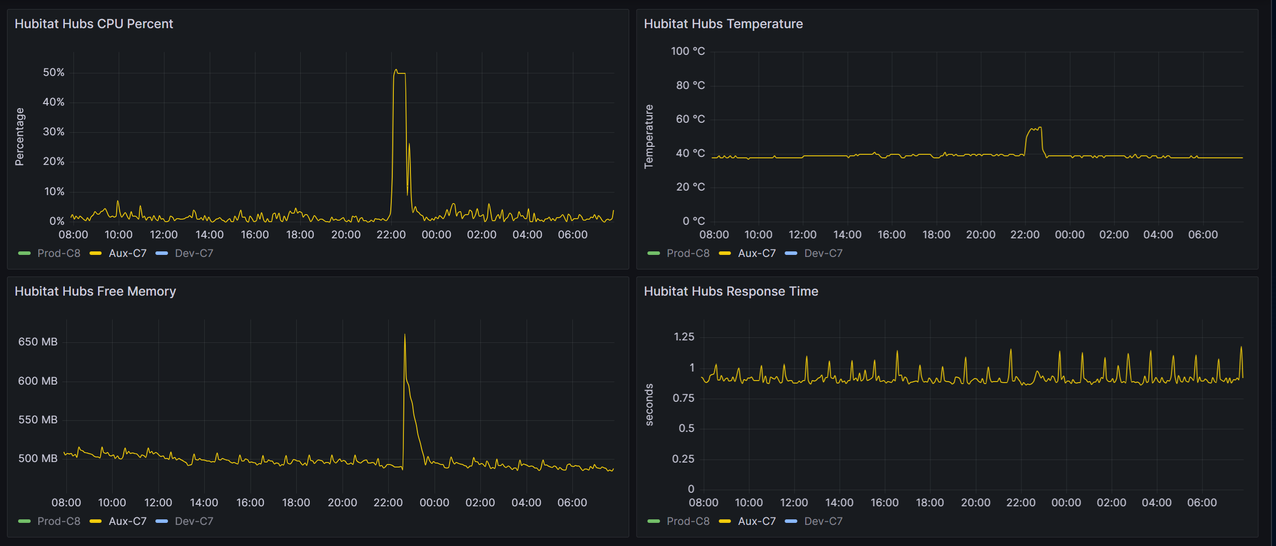

This hub is very lighted loaded with mostly LAN and Cloud integrations. It has no Zigbee, no Z-Wave, and no Matter devices paired with it. CPU, Memory, and CPU Temp shown below.
As you can see above, something consumed a ton of CPU time, causing the Temperature to rise. Free memory was not an issue, as the hub still had ~500MB free at the time of this event.
This hub had been rebooted earlier yesterday morning, via an automated rule that runs weekly at 5:30am. And, I made no changes to this hub yesterday whatsoever. This is a strange one, for sure. I just wish I could have brought up the Logs page to see if I could figure out what was consuming the CPU.

I am using a combination of tools to collect and display the data shown in the above charts. I am using Node-RED to collect the data from my Hubitat hubs using http endpoints. Then, that data is formatted properly and inserted into an InfluxDB server. Finally, I am using Grafana to display the data from InfluxDB. I am running these three tools as Add-Ons on my Home Assistant Yellow hub. They cannot be run directly on a Hubitat hub.
There are other options available as well to achieve the same or similar results. There are multiple threads in the community discussing the collection, storage, and display of HE Hub statistics that you may find interesting.
