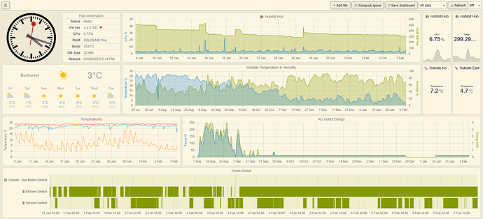

I checked your documentation page, and wondered where the clock came from. I don't see anything in there that says how to add it (unless I missed it; been a long week).

This is an example usage for the Iframe tile type.
To add that exact clock widget to the dashboard:
  1. Download this clock.html file to your computer, then upload it into Settings/File Manager (where the "watchtower.html" and "watchtower.js" files are).
  2. Add a new dashboard tile with type "Iframe" and provide the URL to the "clock.html" file (in your case: http://[enter your hub IP]/local/clock.html?theme=light). Note: you might need to use "https" instead of "http". You can also change the "?theme=light" with "?theme=dark" in the widget URL if you use the dark theme in your Watchtower dashboard.
The same technique can be used to add any type of widget to your dashboard, for instance one of those free weather widgets. Maybe I should add more custom tile types like clock, weather forecast, air quality, etc.
