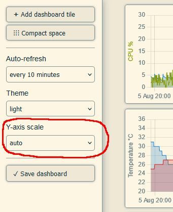

Released version 1.1.0 with the following small change:
Added
- Add option to set charts y-axis scale to "auto" or "fixed" - @marktheknife
Screenshot
This option is saved per dashboard and affects all charts that it contains. The default value is now "auto".
Have fun!

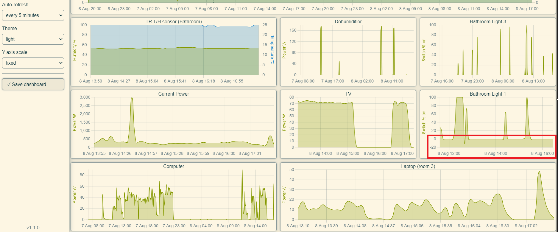

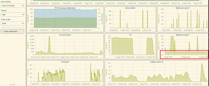

@dandanache,

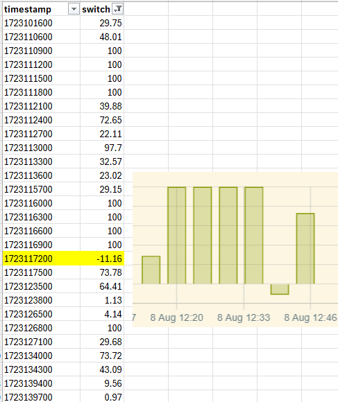

I have added light/switch or dimmer, but for some reason there is a negative value, is it possible to fix this (see bathroom light 1 below)?
Thanks again

This is weird, I cannot reproduce it. Can you please look into that specific csv data file (Watchtower/Devices/click device/click data file) and see if there is a negative value in there? Otherwise it is a UI/graph rendering bug.

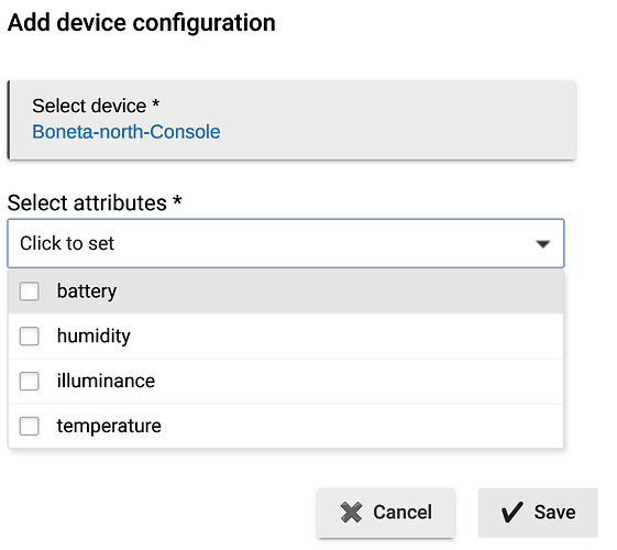

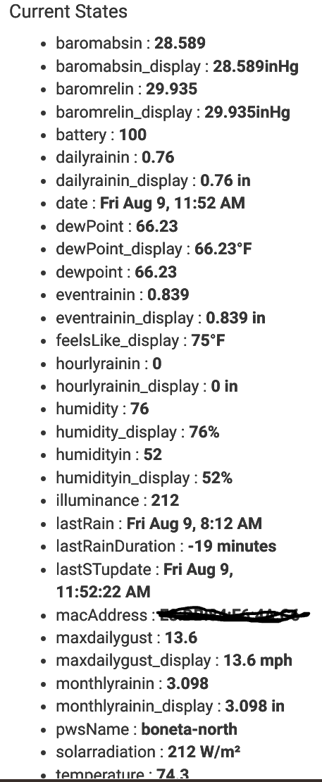

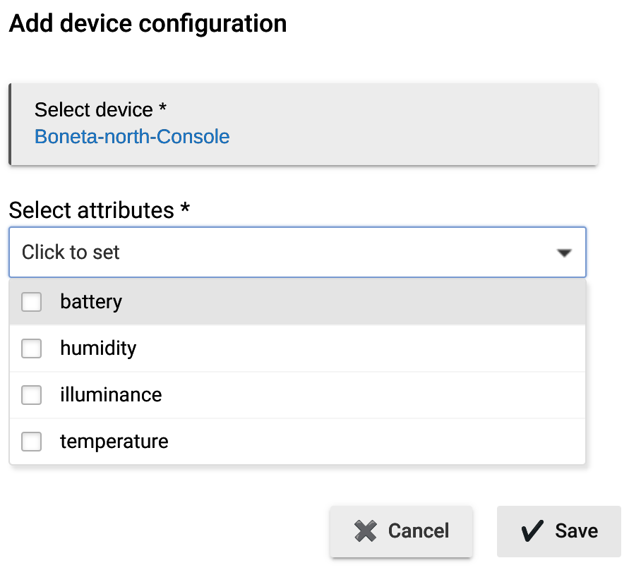

Curious about the limited attribute choice.
There are 53 attributes available for this weather device'
How many are type 'NUMBER'?
Most, wind speed, daily rainfall, weekly rainfall, barometer, dew point, etc, objective weather data.
What driver is that?
If I grabbed the right source it looks like 22 of the attributes are listed as type number, so that's not the criteria. Guess I'll poke around in the code to see what's he's using.
Edit: Found it. He has a list of standard attributes that he's looking for. He may entertain adding some more if you ask.
Attribute List
