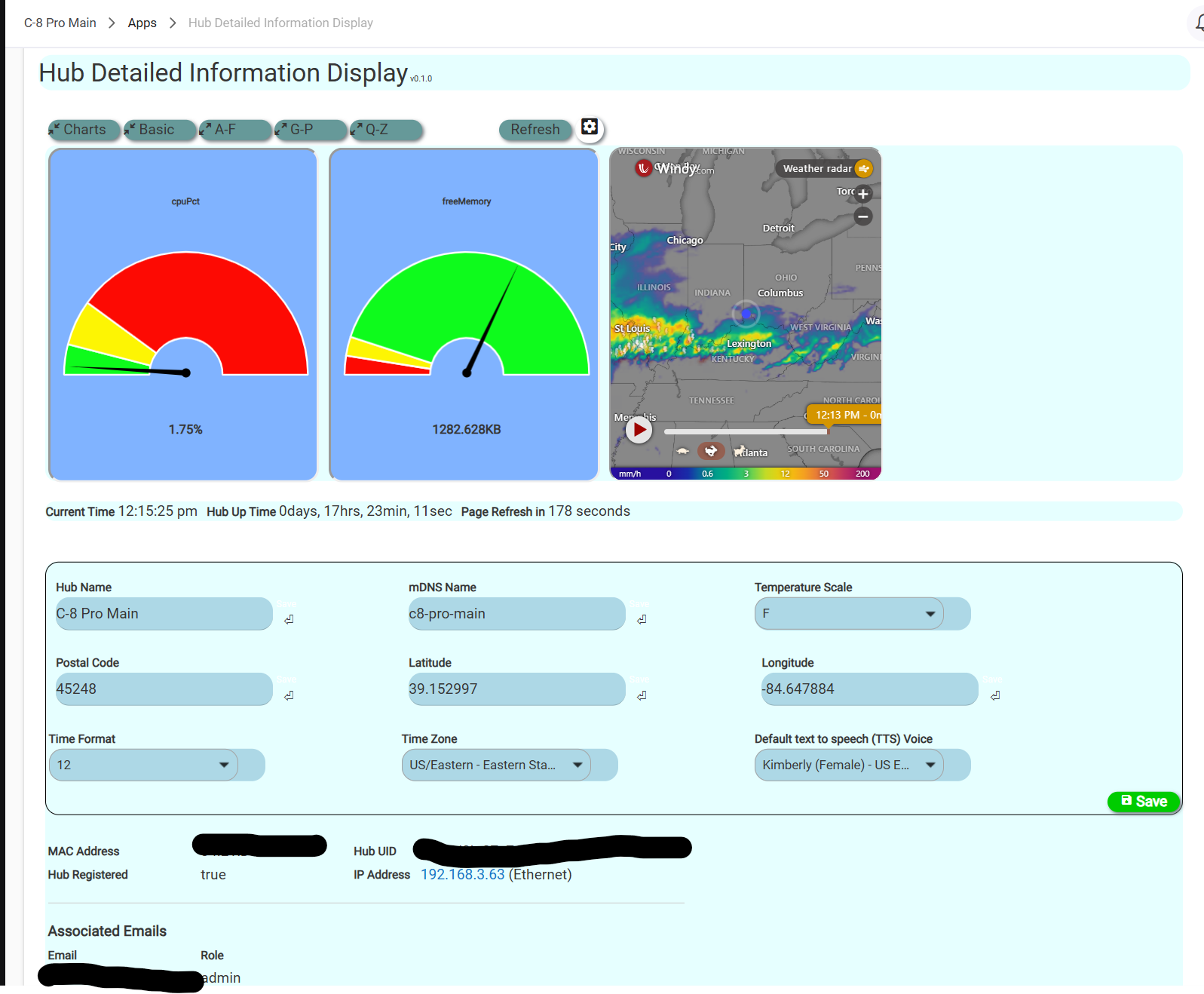

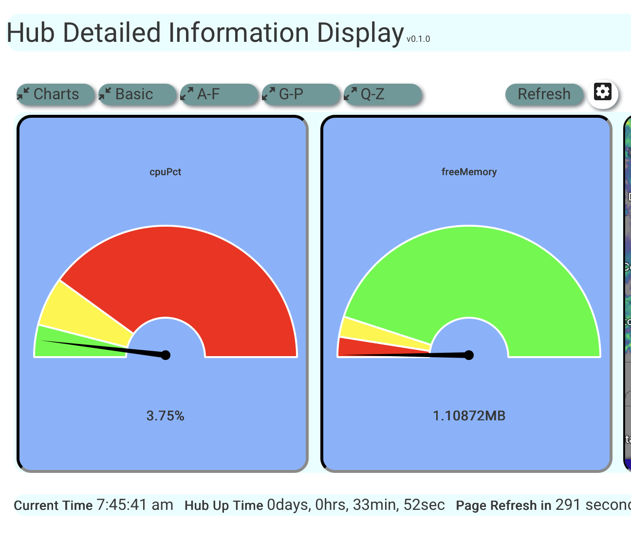

Put this in the because someone asked if it could be done category. App combines the data from the Hub Information Driver with the data and functions of the Settings - Hub Details page. Configuration of the app requires that it be given access to a Hub Information Device v3 to pull all of the additional attributes from without duplicating code.
After configuring the initial page will show gauges with the current CPU % and the current Free Memory readings, along with a radar map derived using the latitude and longitude of the hub. Immediately below this data is the data from the Hub Details page - it is live data and can be updated.
These two areas, along with the Hub Information Driver attributes can be hidden or expanded using the buttons across the top or bottom of the screen.
The page has an automatic refresh built in at 5 minutes to ensure the attribute data is being kept fresh. This doesn't force a refresh of the Hub Information device, merely goes out and grabs the latest attribute values from it. The Refresh button WILL force a refresh of the device, and then refresh the page.

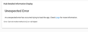

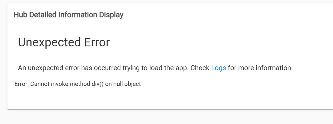

Third, Error loading Hub Detailed Information Display App
2025-04-04 03:04:36.402 PM error java.lang.NullPointerException: Cannot invoke method div() on null object on line 360 (method pageRender)
Because I forgot to enable attribute polling on Hub Information Driver v3. :face_with_open_eyes_and_hand_over_mouth:
Set CPU/Memory polling, then loading Hub Detailed Information Display App produced a really nice display just like you'd expect.
Fourth, went into settings and thought "Hmm what would happen if I select a Temp sensor?"
Answer: Back to error and App not loading.
So, I'm about to delete Hub Detailed Information Display App and re-install it but thought I'd ask if there was another option to get to the device select setting?
If you grab the URL for the page that is erroring out and change the last part to configPage it should load the configuration page for you
http://<hub IP>/installedapp/configure/<app ID>/configPage
Sorted, thanks.

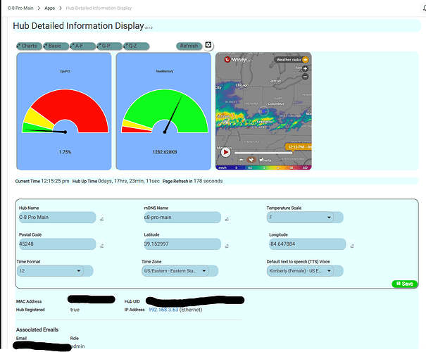

I am having an issue w/the Weather Radar option...the close "X" gets cut off when the radar option slider appears...
As it opens/slides over:
25-04-04-3070
When fully open:
Tried various zoom levels, nothing would make it appear.
Chrome latest on Win 11.
Try to click on the left edge and pull back to the right.
Thanks...
Hand can't grab anything to drag, as far as I can tell:
25-04-04-3074
But if I move really slowly the hand gives me the finger ( :wink: ) and I can close the overlay:

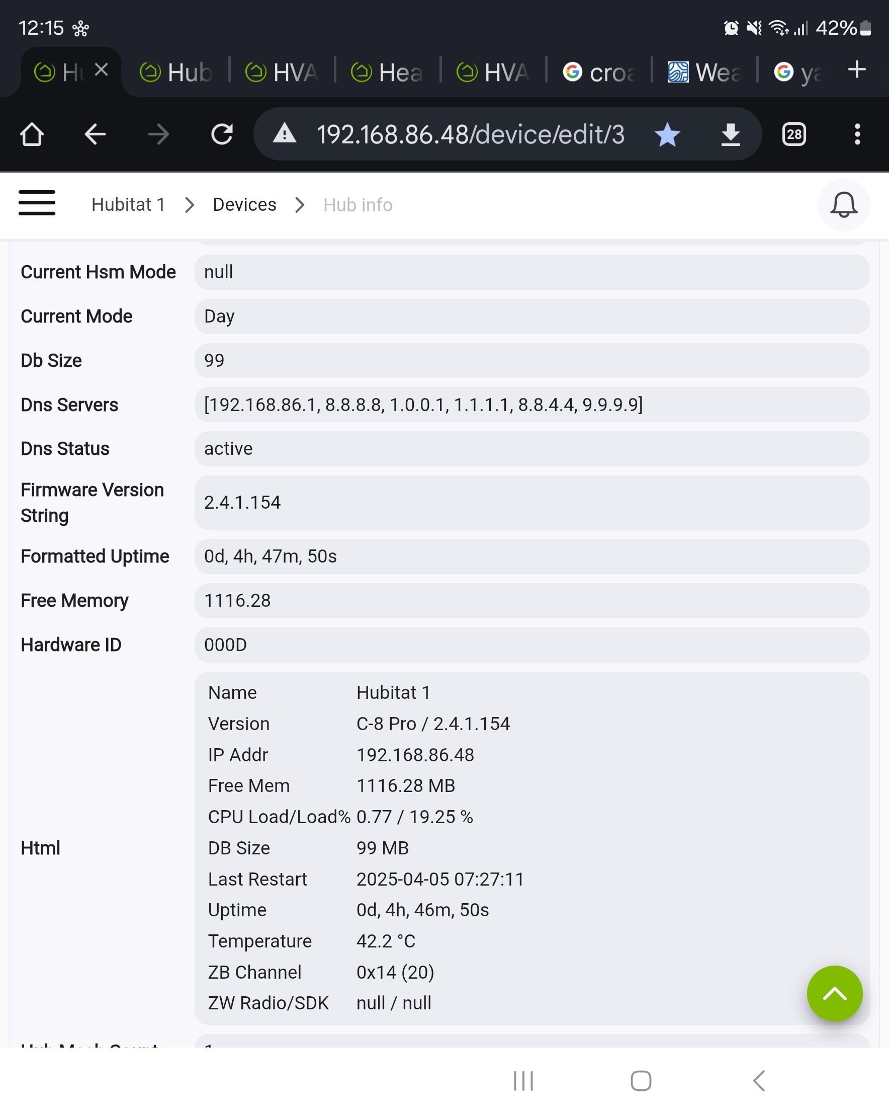

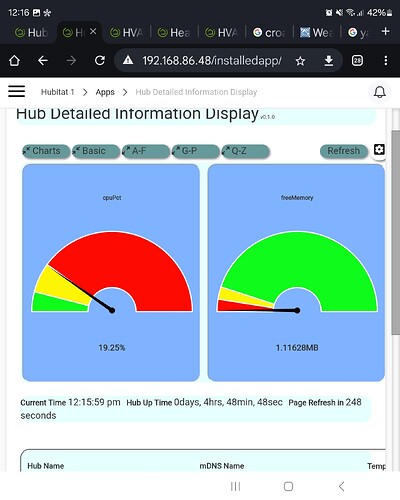

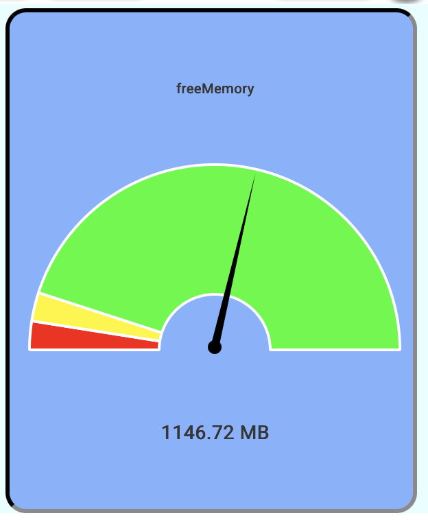

Is this reading of Free Memory different for anyone else?
My Hub Info page for reference
You have your Free Memory unit set to MB (default is KB) - I’ll need to make a small change for that option. Thanks for finding that one.
Ah. Same for me too. Thanks!
V0.1.1 is up with the fix.
