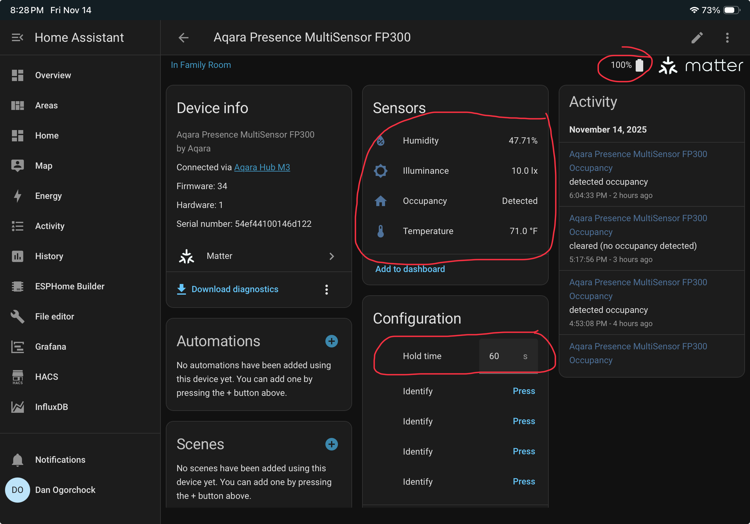

I received my FP300 yesterday and switched it over to Zigbee via the Aqara app. I then decided to try pairing it to my Aqara M3 hub to explore all of its capabilities. I must say, so far so good. Pretty small sensor, and has worked without fail thus far. I have a Home Assistant Yellow hub running as well, which is linked to the Aqara M3 hub via Matter. The new FP300 showed up immediately in HA as shown below.
I was pleased to see that all of the sensor values and battery level were brought in via the Aqara M3 Matter bridge. The hold time was nice to see as well. I did change the hold time in the Aqara app and the value was changed in HA as well. So far, so good.
I used the Home Assistant Device Bridge (HADB) integration to bring in the FP300’s “Occupancy” sensor into my HE C8 Pro hub as a “Motion” sensor. I added it to an existing Room Lighting automation that was currently failing due to the existing Aqara FP2 sensor being partially blocked by the Christmas tree. :wink: Since adding the FP300, this RL automation has once again worked flawlessly.
I am impressed and very pleased with this purchase. Once the Hubitat Zigbee drivers are worked out, I will probably pair it directly with my C8-Pro hub to see how well a direct integration works. For now, HADB is being used for my Aqara FP2 sensors and the new FP300 sensor. Performance is great, so no need to change anything today.

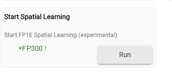

It’s also crucial to calibrate the FP300 after configuring all parameters and preferences. Make sure the room is empty, then click “Start Spatial Learning” so the sensor can accurately map the environment without any people present.

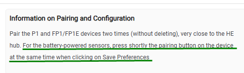

Before I continue adding the remaining advanced FP300 parameters, there is another important improvement needed in the driver: confirming whether configuration commands are actually received and accepted by the device.
Unlike the DC-powered Aqara mmWave sensors (FP1, FP1E, FP2), the FP300 is a battery-powered Zigbee sleepy device. To preserve battery life, its radio is off most of the time and only wakes when certain events occur — motion detected by PIR/mmWave, changes in temperature/humidity/illuminance, etc. As a result, when Hubitat sends Zigbee commands to a sleepy device, the device may or may not be listening at that moment. This is not unique to Aqara — many battery-powered sensors from different manufacturers behave the same way.
Most other Zigbee ecosystems (Aqara, Tuya, Sonoff…) account for this internally and use various mechanisms to ensure that settings and commands reach sleepy devices reliably. Hubitat does not provide a built-in solution for this — so the driver has to implement its own mechanism. I already use such a system in a few of my other drivers (for example the 'Tuya Temperature/Humidity/Illuminance LCD Display with Clock' driver ), but it has not yet been added here.
The plan is to introduce a status attribute that will report success or display a warning after preferences are saved or a command is issued. If the driver does not receive confirmation back from the device, the status will prompt the user to wake it up and try again. There is also the option to implement automatic retries: whenever the device sends an event and briefly wakes up its radio, the driver can immediately resend the pending configuration commands in the hope they will be accepted on the second attempt. This approach works well with Sonoff and Tuya sensors, and I am optimistic it will work with Aqara too.
For now, to ensure FP300 preferences and commands are successfully applied, please follow the guidance provided in the driver’s Preferences tab:
I have noticed the same requirement in the Aqara App with my FP300 paired to the M3 Hub. When changing certain parameters, it prompts the user to press the button on the FP300 to wake it up to establish a real-time connection to it. I am glad they chose to prioritize battery life over ease of making these very infrequent setup changes.
