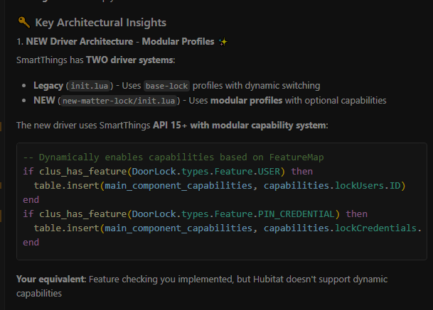

Even Claude Sonnet 4.5 wants Dynamic Capabilities too!
:slight_smile:

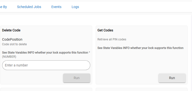

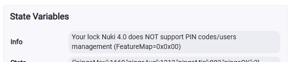

Edit: this is the best workaround I could come up with for now:
