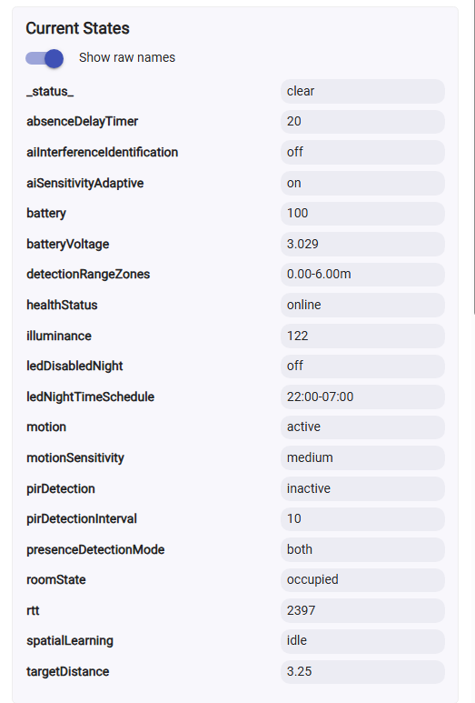

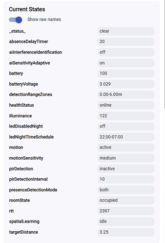

ver. 1.9.3 2025-11-14
fixed FP300 illuminance handling and the calculation formula;
enabled motionSensitivity for FP300;
FP300 fingerprint update;
bugfix : no response on ping() command was switching FP300 healthStatus to offline
added battery voltage and percentage events for FP300;
enabled advanced options for FP300 illuminance sensor

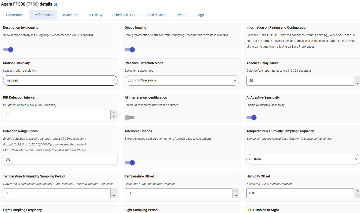

version 2.0.0 2025/11/15 11:58 PM (dev. branch) :
BREAKING CHANGE: Added child device support for FP300 temperature & humidity; FP300 T/H readings now appear in a separate child device using Generic Component Temperature Humidity Sensor;
BREAKING CHANGE: removed TemperatureMeasurement and relativeHumidityMeasurement capabilities from the parent driver;
BREAKING CHANGE: added deviceTemperature attribute for non-FP300 devices internal temperature;
added advancedOptions preference toggle;
added separate tempOffset and humidityOffset for FP300;
added experimental trackTargetDistance() command for FP300
MAJOR CHANGE: Intelligent Parameter Change Detection :
implemented for FP300 and illuminance reporting
store parameters in the state.params [n:name, t:type, v:value, l:local]
only sends changed values to prevent Zigbee flooding and potential device instability
'Spatial Learning' starts a process for calibrating the FP1E/FP300 sensitivity, and it appears to be effective! This feature was recently added to the driver.
