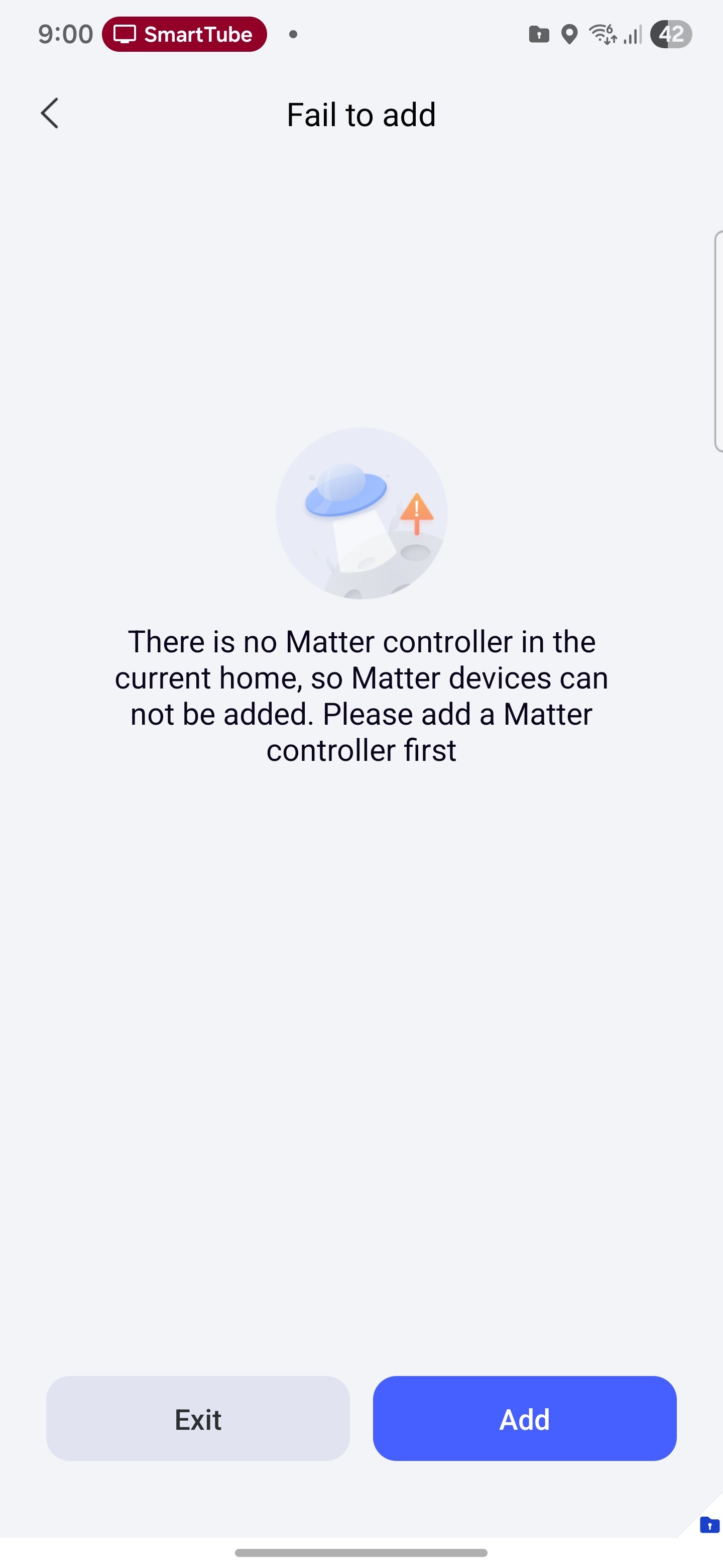

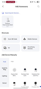

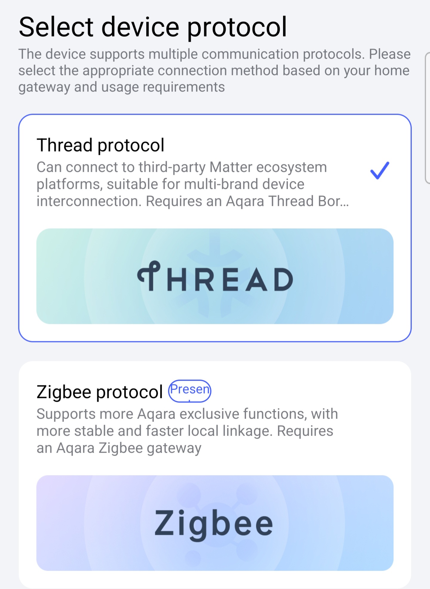

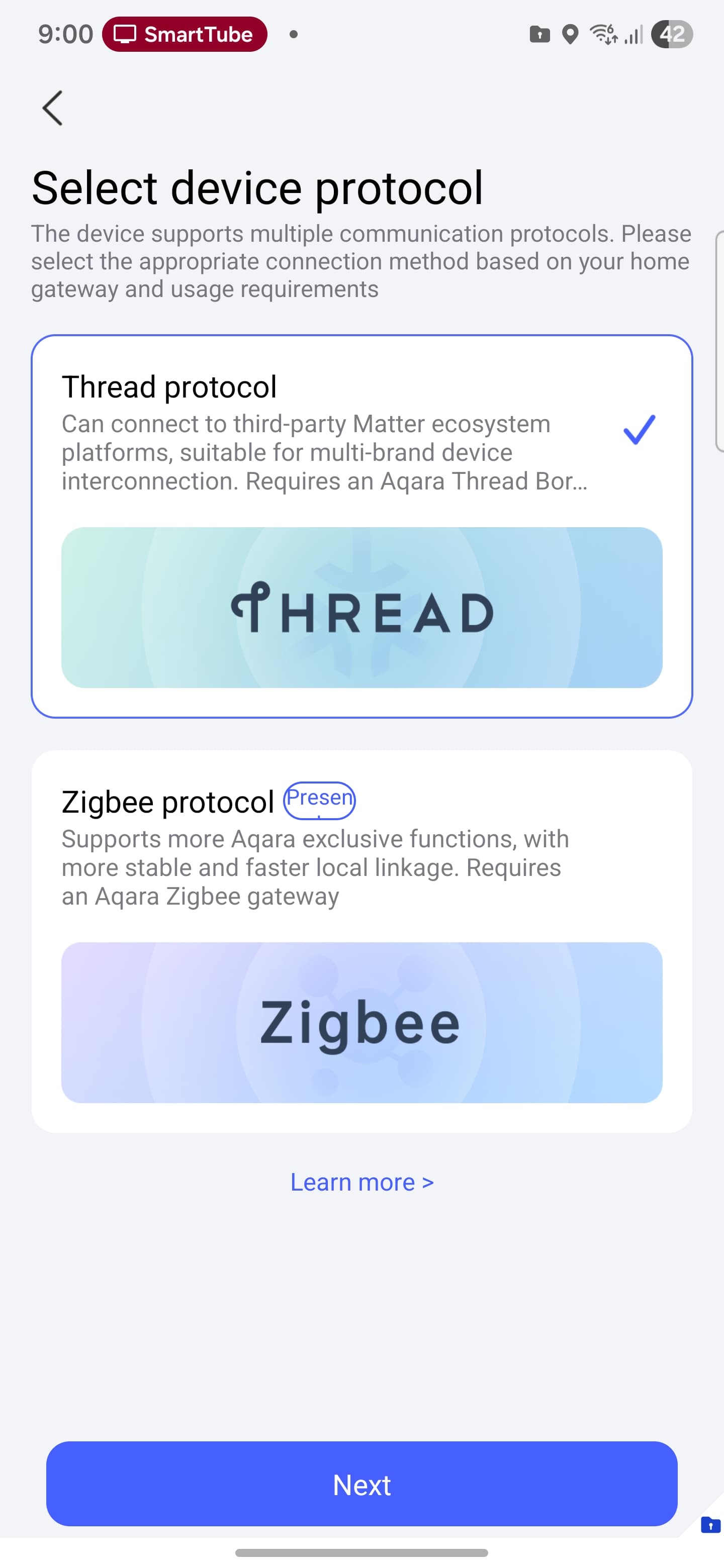

Yes, I would say initial communication is possible with Aqara Home app, see screenshots for Aqara TRV below.
Once the device is in pairing mode, you can select either Thread or Zigbee protocol.
However, you will not be able to do anything in Aqara Home if you do not have a supported Thread border router or a Zigbee gateway connected to Aqara Home.
Good news is that you can switch to Zigbee protocol then pair the Zigbee device in Hubitat as normal :grinning:
