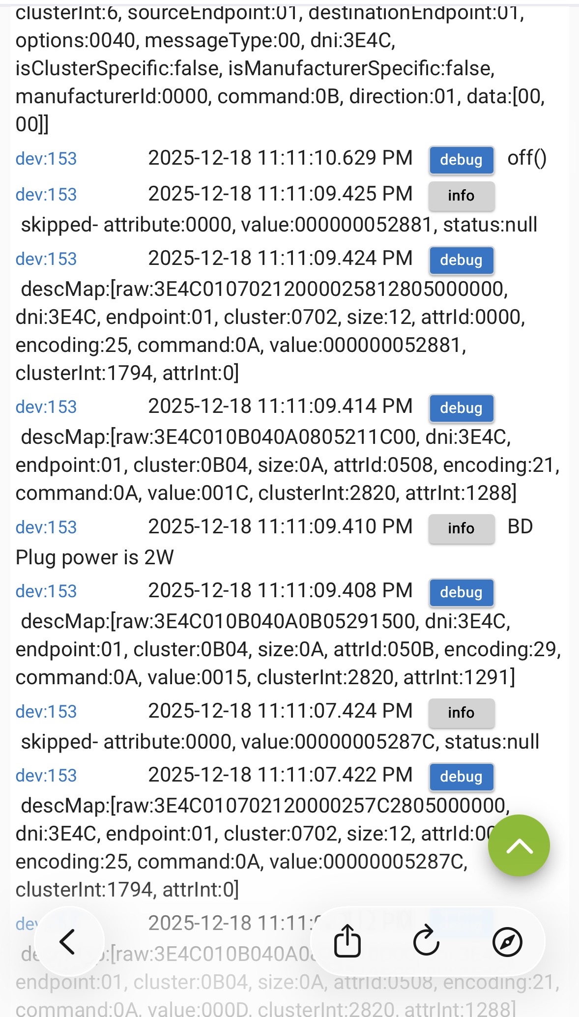

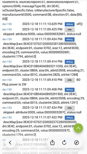

  1. I did this right after I posted this actually. Everything looks pretty normal I think although I did see that both of my ThirdReality Zigbee outlets are producing a TON of debug and info logs.
That is 1 of 9 screenshots exactly like that all within a single minute, 11:11 pm. Approximately 80 messages in that minute. All of the info logs are just reporting wattage, varying from 0 to 2. I honestly don’t know what the debug messages are for. They just seem to be providing specifications about the device… I’m not sure if this is part of the problem or how to stop it.

Hover on the "Info" and "debug" icons and you'll see the name of the device. Click on them and you'll go to the device page.
On the device page, unless you need power reporting, disable it in the devices Preferences.

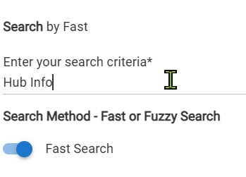

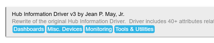

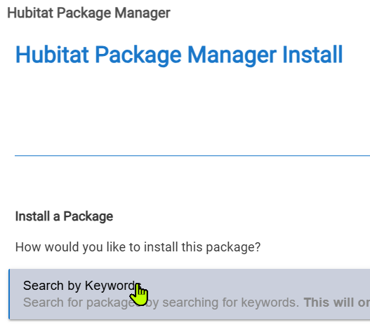

Search for "Hub Info" in HPM and install the v3 version:
It adds a virtual driver - use that from your Device page, Add Device at the top, and choose the Hub Info driver as the virtual device's driver.
Additional: Once the virtual Hub Information driver is installed you can configure it to watch what you are interested in, and use it's output in rules/automations as well. More info, and ask questions herre:

I checked the power reporting on my outlets, and they are both disabled... but it did have description-text logging enabled, so I disabled that, maybe that will do it.
Descriptive should be fine to keep enabled, as long as you've disabled any specific power reporting in Preferences you should be good.
Some devices are "chatty" and can't be limited as much as needed/desired. What devices are doing the power reporting?
ThirdReality Zigbee Outlet/Plug. I already had the power reporting disabled but I was getting tons of logs about it. Turning off the description text logging just now did stop the logs, but not the events. I just turned it on and got 10-15 power readings under the device events page in the first minute, and climbing.
