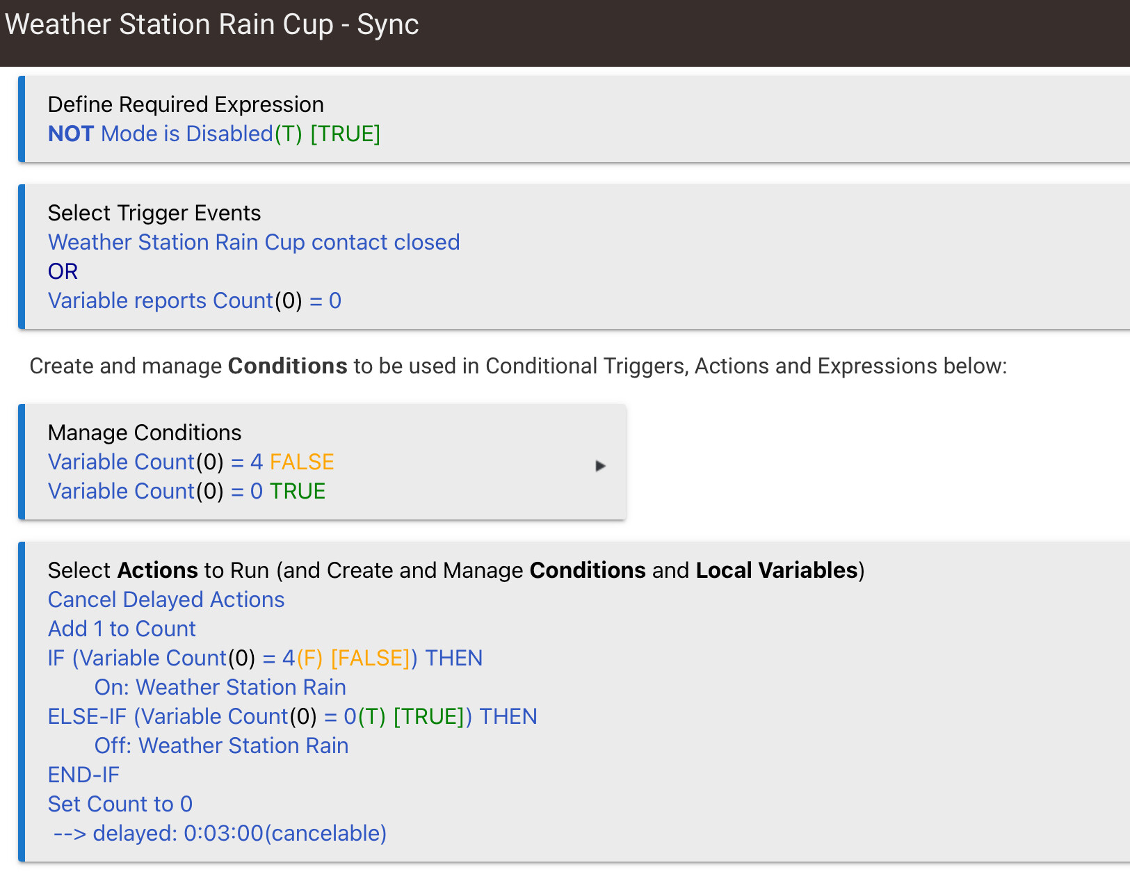

I wont say this is the best way, but it is the best way for me. I wired a self emptying rain meter to a zwave contact sensor. The emptying of the rain cup causes the contact sensor to open/close.
I use this automation to control a virtual switch, on = raining, off = not raining

Either way that’s my 100% local way to detect rain thats been 100% reliable for years.

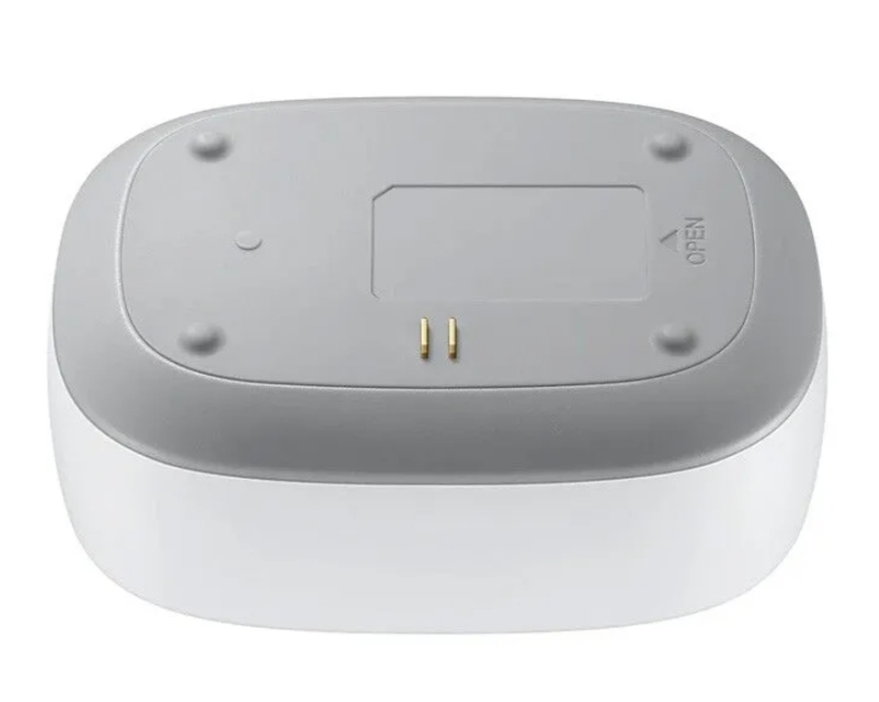

I think that the Aeotec / Samsung sensor would work. I suggest that you try it positioned at a 45 degree angle with the bottom electrodes facing up on the lower edge. They are close together and should be triggered by just a few raindrops. The water would run off. No need for a plate. I'm not sure how well the device will last with full outdoor exposure. You could try painting over the seam between the two pieces with rubber cement and pealing it off to change the battery.
While a regular "leak sensor" would detect rain quickly, the reset time, after the rain ended, would be unpredictable. I also think most leak sensors have built in audible alarms, which could be annoying. Also many of them are not designed to work when submersed in water, which could happen in heavy rainfall.
