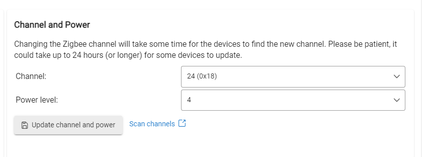

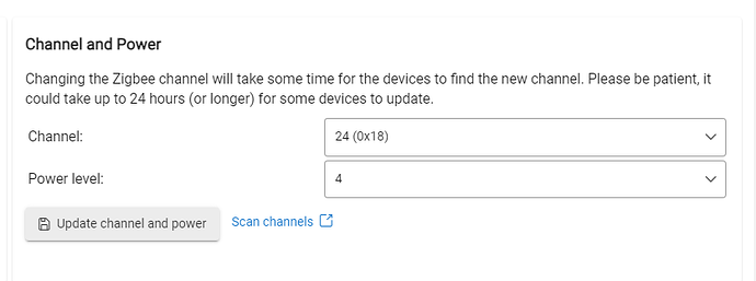

Power level is 20. I don't recall if I changed as part of testing or back when I had wifi issues a year ago. All I know is I had the drop offs after the last update. Are you suggesting I move to channel 20 and power level 4?
BTW, what is your thoughts on why the S40 seem to be impacted?
Keep the channel as it is now, the problem is not in the channel number.
However, I would recommend to lower the C-8 Zigbee radio level to 4 (or maximum 8). The reason is that with such a high power (20) you create a huge asymmetry between the receiving and the transmitting capabilities of the end devices. The end devices are low-power, they will hear the very strong C-8 hub and will try to send the messages directly. However, as their signal is much weaker, the C-8 will not hear / will not decode their messages!
The C-8 Zigbee high power creates more problems, than bringing anything good in my opinion. Lower the power to 4 or 8. I think that the Hubitat default setting is now 8, so don't increase the power to higher than that.

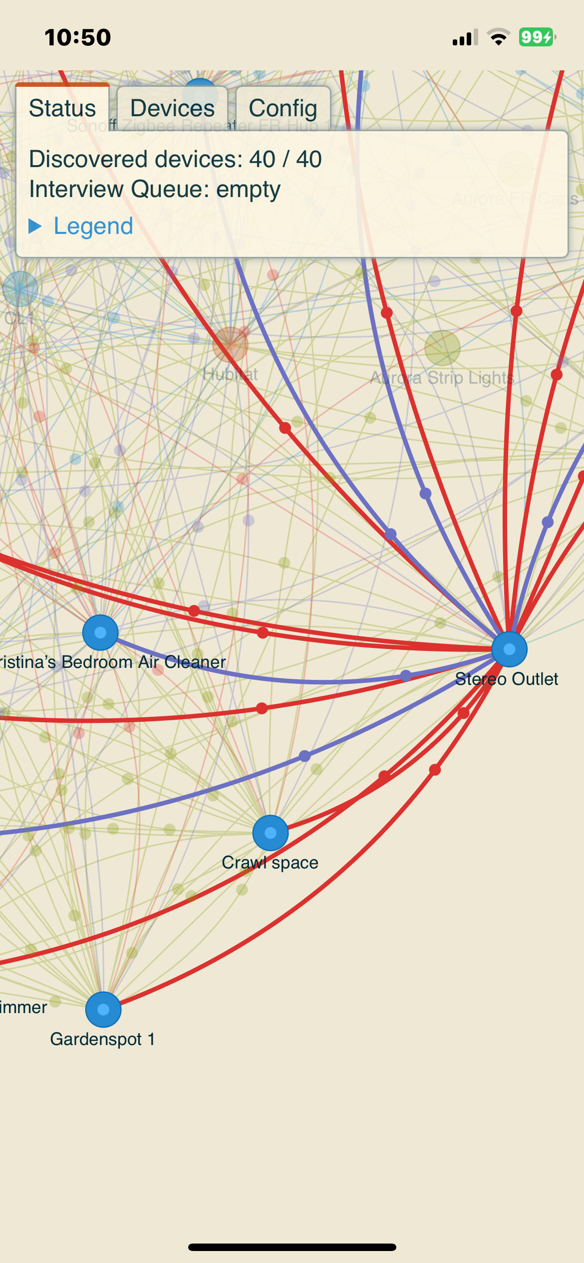

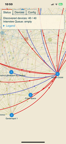

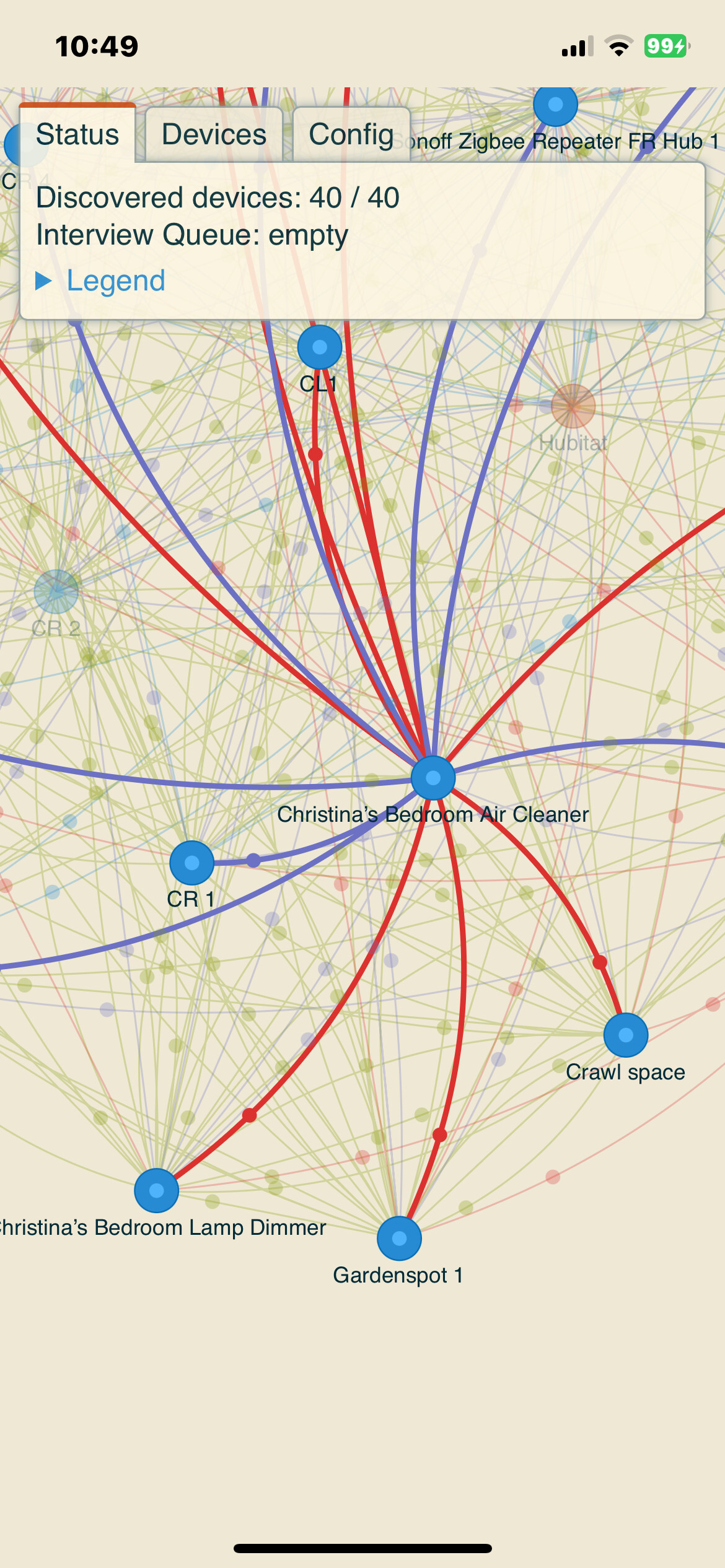

They do seem terribly weak, signal wise. I have 2 of them that have been perfectly well behaved, but I have never seen anything repeat through them. I do have them on my ‘Zigbee lights’ mesh where they can’t do any real harm since there are 36 other repeating devices on it.
Here you can see that despite being surrounded by Zigbee repeaters, neither has a single strong connection to anything.

Note I downgraded to signal strength of 8 for zigbee back when I got things fixed. (originally 25)
