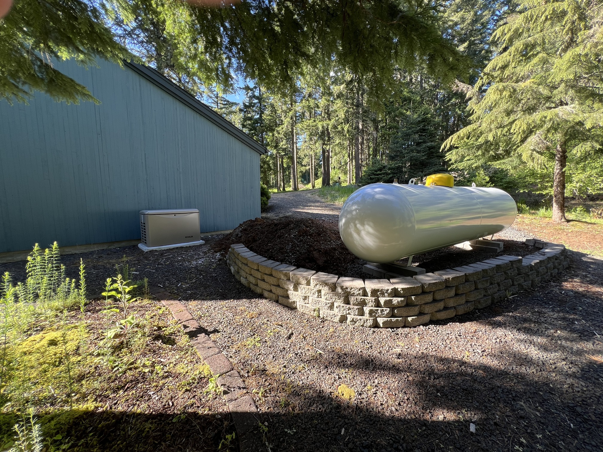

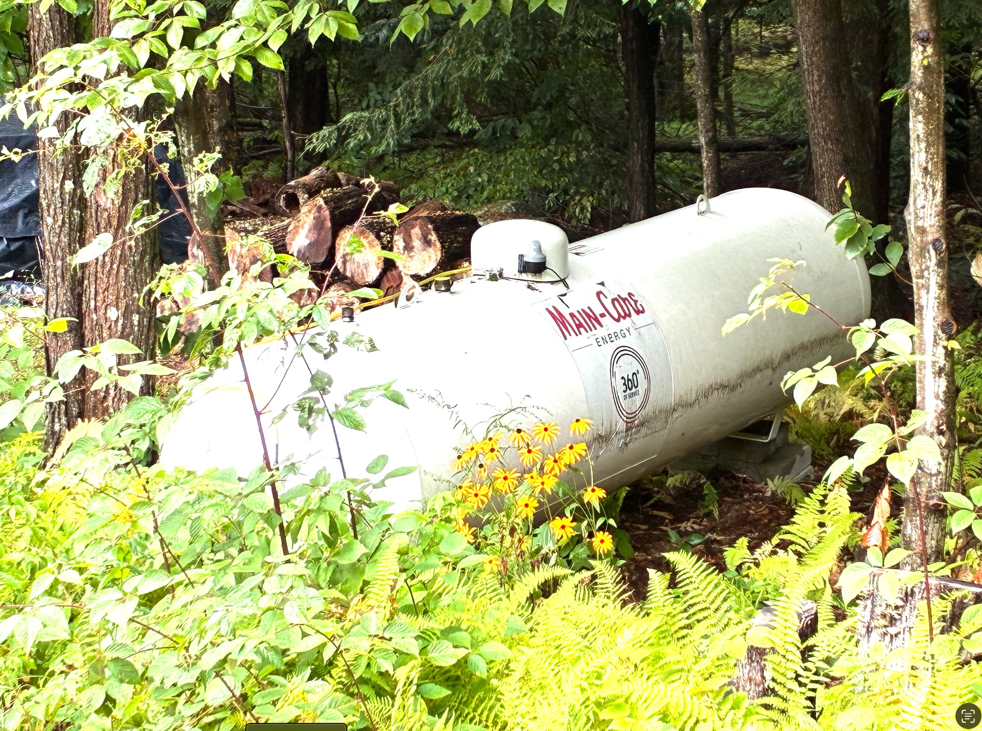

My tank is more camaflouged, lol:
edit: That's a Sinope tank level sensor by the hatch.
I've got the same sensor. I'm guessing at the 2 weeks. We can always go to our vacation home if it longer than that.
