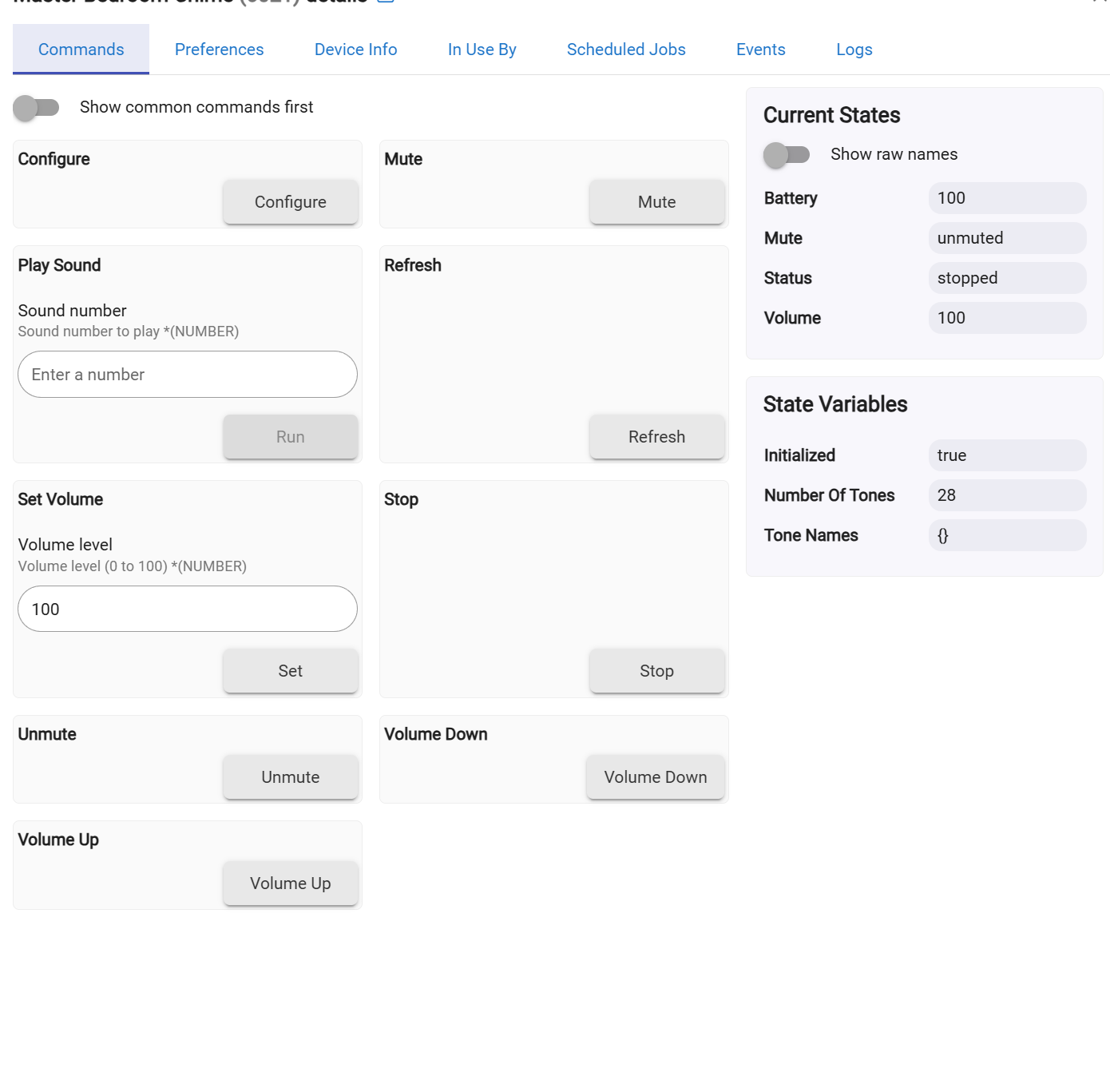

Received mine yesterday. Here is what I see on the Commands tab. I was hoping to use the LED to indicate various conditions around the house (garage door open, AC set to on, etc.) but it looks like that will have to wait a bit.

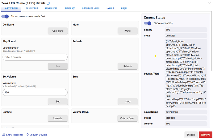

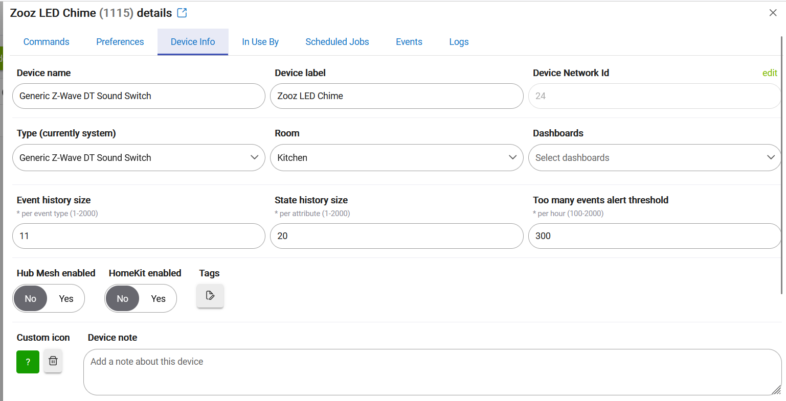

Did you pair as "generic z-wave dt sound switch"? Curious why your sound files are populating but mine aren't. Did you pair with ZW-LR or mesh? Are you using ZWJS or standard?
Sorry for so many questions
I let HE find it and accepted the defaults.
Are you on zwave-js or zip, I'm guessing my issue is that I'm using zwave-js if so
Edit: switched to z-wave legacy, all states are now showing like yours. Thanks
