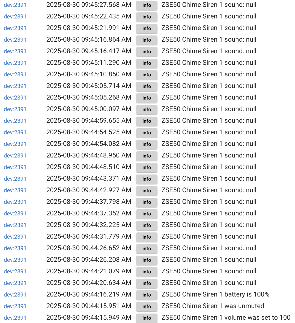

Tell me, what happens when you run Sound Number 2?
I'm still getting a null, with red flashing light.
Have to run another sound to get rid of it.
edit: Plus, right now, I'm not getting anything in logs when I hit Configure, or anything at the moment.
edit2: Plays sounds, except for 2, but logging nothing. Weird.
edit3: Logging now. Had to save preferences.

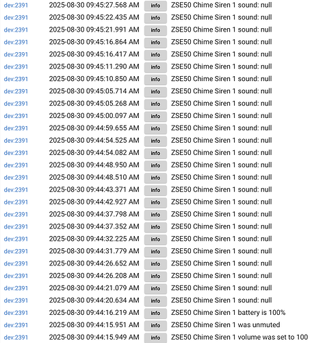

When I hit Configure now, I get a blinking red light, like when Sound 2 is chosen, and an unending Null logging stream, until I play another sound number:
My number 2 is one of the files with the underscore. When I play it I just get a flashing red light. It eventually turns off or I can hit stop to stop it.
I don't get any of those errors in the log.
