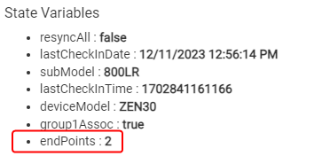

You need the updated ZEN30 driver I posted recently, and probably need to run a configure so it can detect the endpoints correctly. They changed the endpoints and I tested it on the 800LR 4.10. They told me there was an update for the v3 in the works but never sent me the firmware.
You want this to show up in the states:
Got it, thanks! Endpoints showing up now, and the child works as expected.

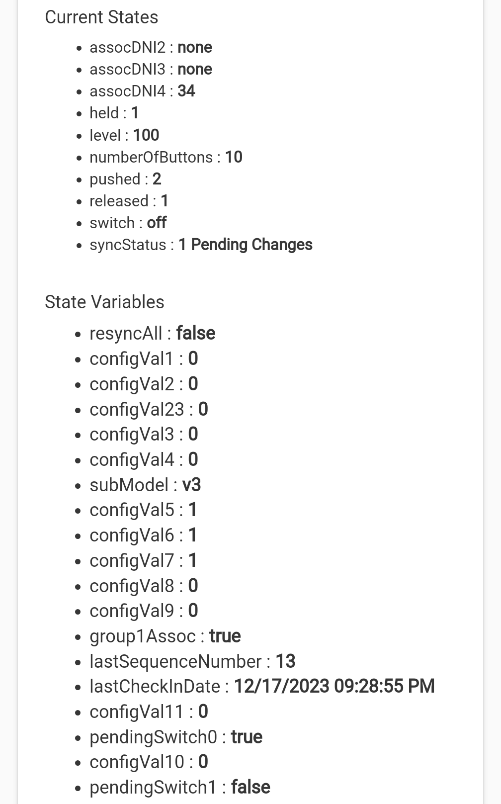

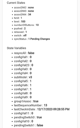

Well I've got 1 pending change with 3.2. I didn't want to use the 800 driver because... it's not the 800 model. But sounds like it doesn't matter.
Its not a special driver for the 800LR, it is universal. The updated driver in my HPM package is for all ZEN30 models from v1 to current.
If you want to enable debug logging and then press "Save Preferences" at the bottom it will show us what setting it is having problems updating (in the logs). Otherwise when I get a chance to update my device I will check it out as well. Looks like I might need another driver update to fix this.

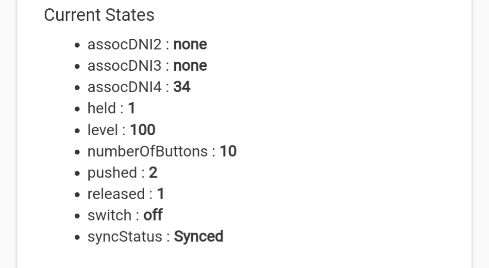

Looks like the pending change cleared up upon saving preferences. ![]()
Now if you run configure once more it should clean up that mess of garbage in the States left from the system driver. I hate how they save all the parameters there, it bothers me especially since it is all obviously not sorted at all.

All cleared up.
