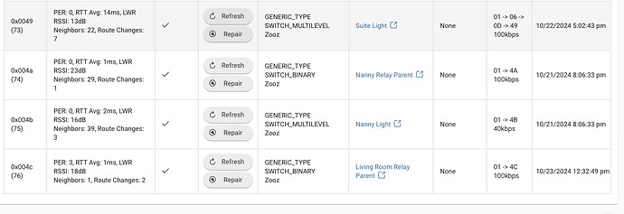

It is called "Apartment Light" (Zen30) and is controlling "Apartment Relay Parent" (Zen 52)

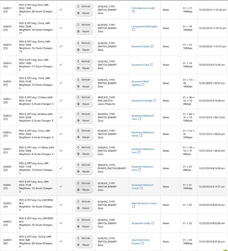

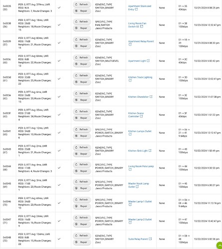

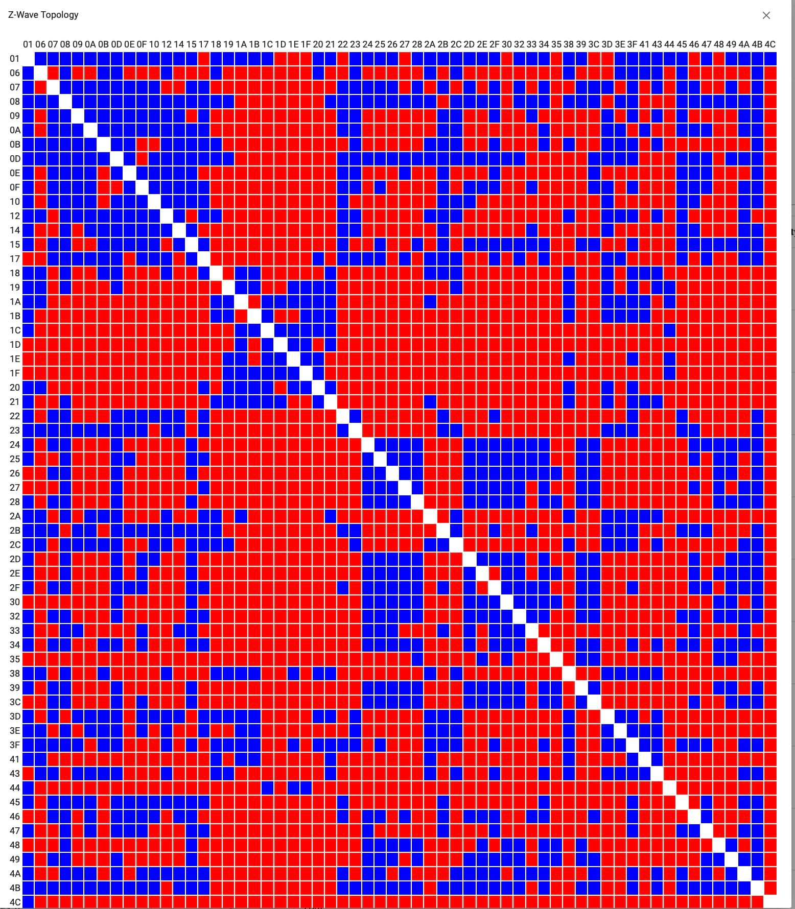

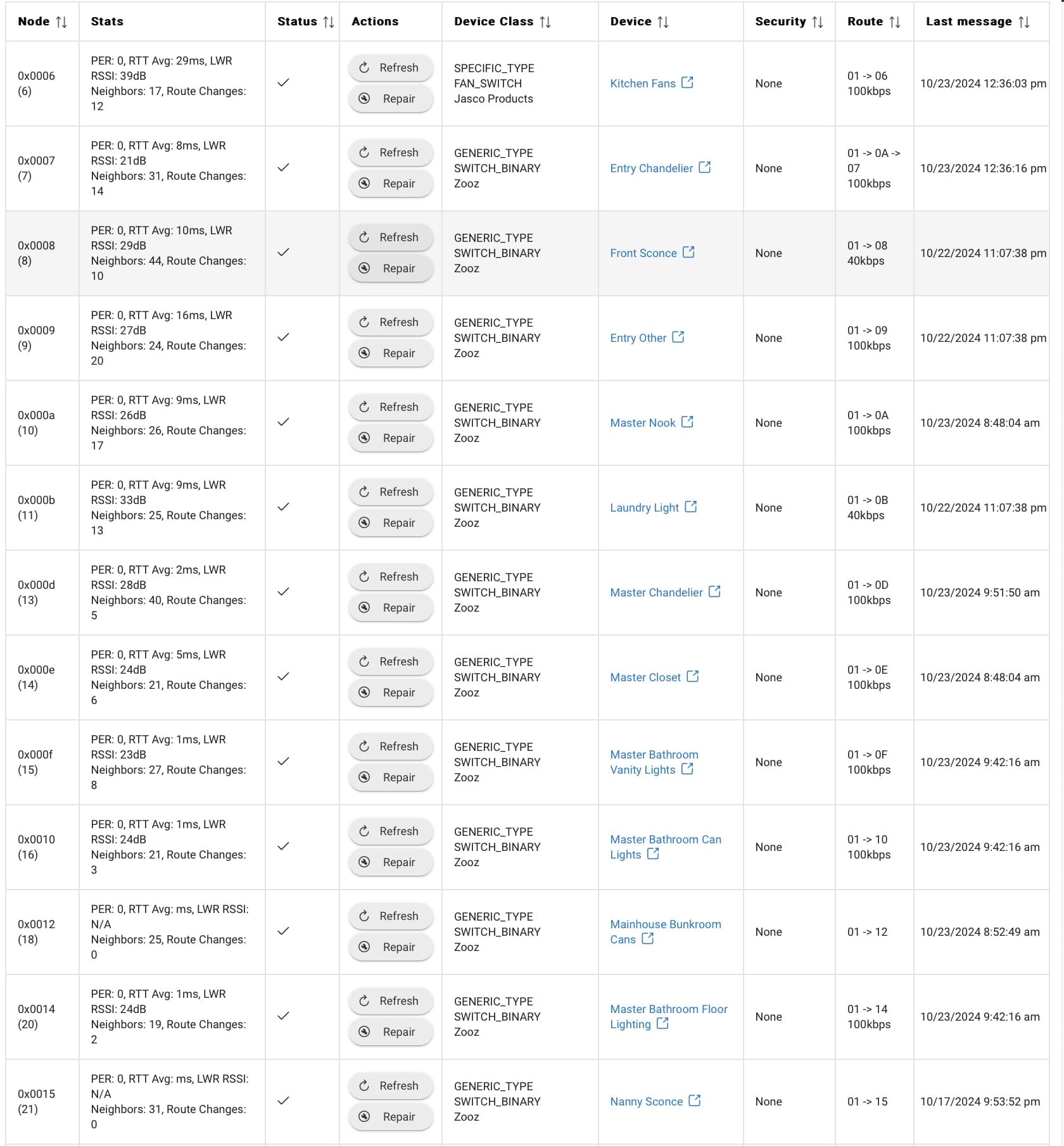

Here is the zwave details and topology. Hub is on 2.3.9.193 uptime of 5d 22h 21m 15s
Nothing really jumps out at me for those devices. The stats on the two problem devices seems to indicate they should be quick.

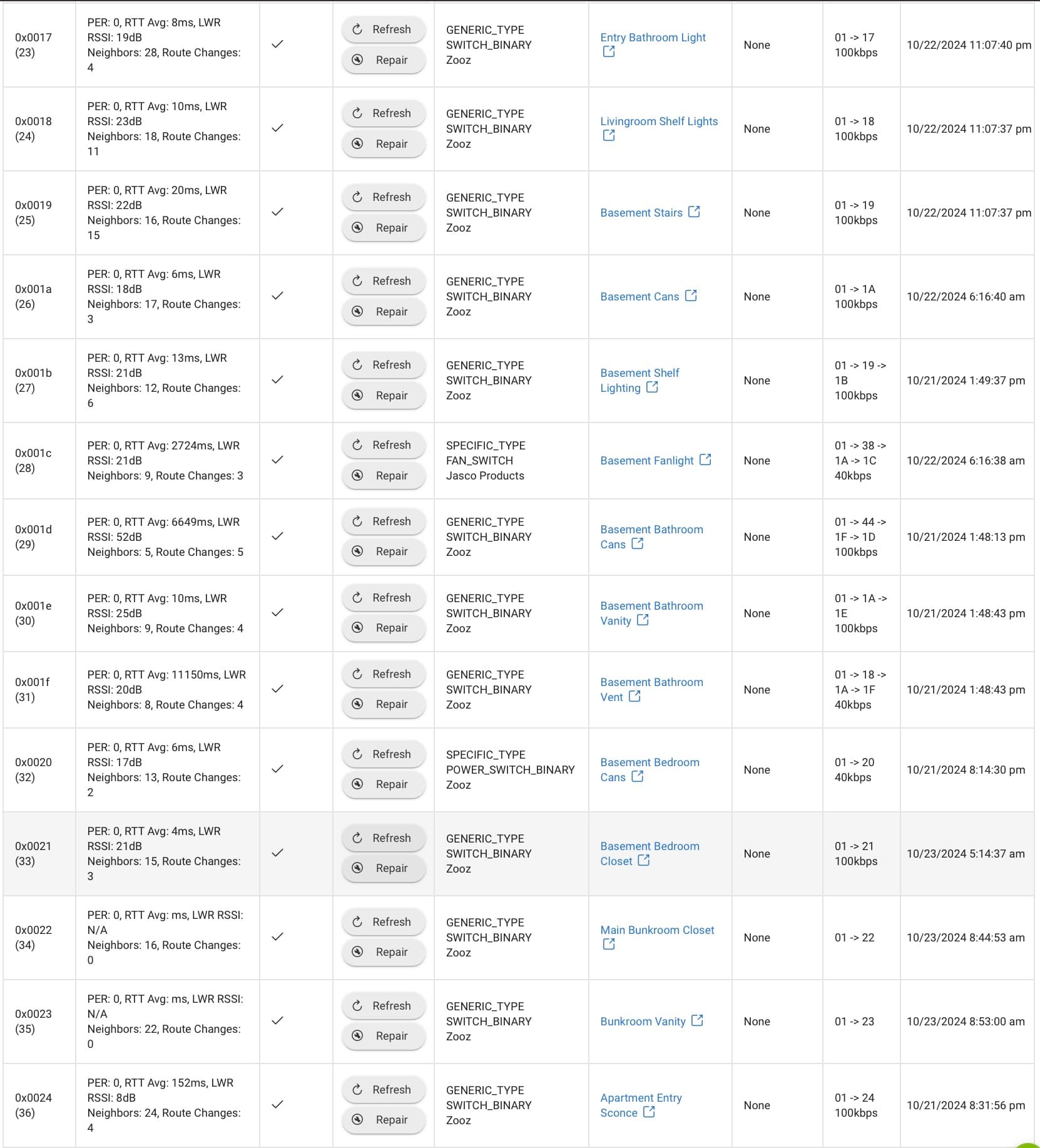

Looks like many of the basement devices are struggling though, based on RTT. Sometimes when you get devices like that it can bog the entire mesh down. A lot of them are trying to route through the basement cans. Is there anywhere you could put a solid repeater down there? Either a smart plug or something like the Zooz ZAC38 maybe? Assuming your hub is on the main floor, may even work best with a repeater in the ceiling, or low down on the main floor directly above the devices.
