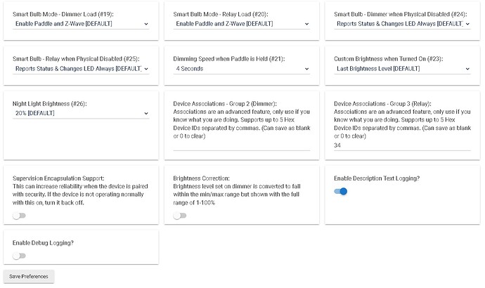

Can you show a screenshot of your settings on the ZEN30? If you have the "smart bulb" mode enabled there could be some cases where the associations no longer get sent out.
Sure. I did notice that when group 3 is assigned and the relay button is pressed digitally, HE thinks the dimmer was triggered. Not so when it's pressed physically.
There was a bug like this in the stock driver (not sure if it got fixed) which was not present in my driver. But you also have a v3 device and all my prior testing was on a v1 device. I just recently got a ZEN30v3 (and a ZEN51) but both are still in the box.
