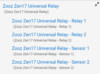

I've been fussing with the ZEN17 to get it to control a spring return damper actuator. I have the type damper that includes "auxiliary switches" that let me detect when the actuator has moved past 5 degrees and 85 degrees. I've got it all working by setting up the actuator power like a DC motor example in the docs and turning on the "Contact Sensor" firmware feature to get the two extra contact child devices (four child devices total). It did require programming the ZEN17 for these when first paired w/HE and then excluding/including it again. Also turned off the "Input Trigger for Relay 1/2" to keep the contact sensors from trying to drive the relay.
