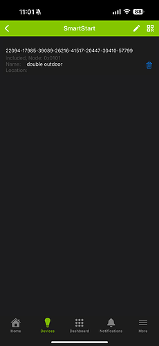

I’ve been trying to pair the Zooz Zen14 outdoor dual plug for the past 3 days with no luck.
I can’t figure out how the smart starting supposed to work. It shows
Included in the app, however I never see a device listed in the device page.
I’ve also set it to no security.
When pairing manually through the wave include, it sees the unit and I select without security and the include timer eventually gets to zero and says there may have been an issue.
I’ve reset the plug and tried again, but the only way to get the interface to see it again is to reboot the hub.

I've tried with all of the S Settings within smart start. i've also tried with the zwave pairing to select both no security and with security entering in the 5 digit code from the device.
