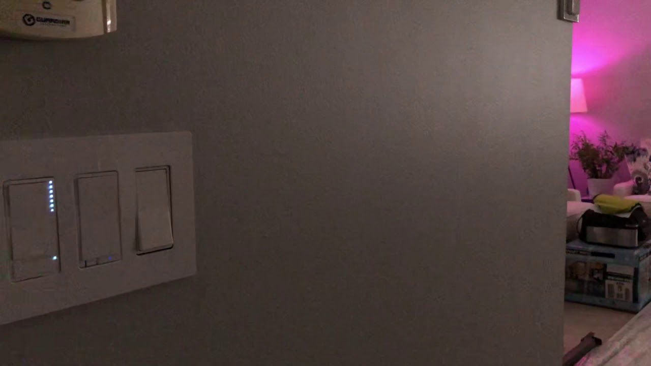

Here is a quick video. Just focus on the switch LED animation and you will be able to notice the magenta light turning on and off (or whatever color that is).
It is not terrible but not good either. If you are walking into a room you will be at the middle of it and it will still be dark :slight_smile:
Parameters look right to me: 13 is set to instant (no delay) and 22 is set to follow 13.
After watching my own video I noticed the LED "animation" was still going on meaning I still had a ramp up even after setting all parameters according to the documentation.
