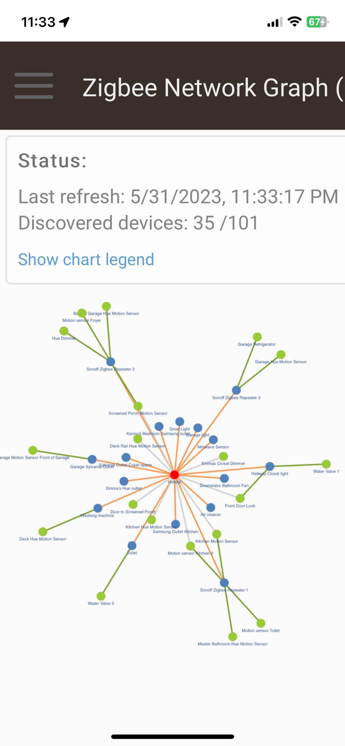

Mine started that way but I let it sit for a bit while it searched for the device here what it looks like so far
while I'm writing this it is up to 12 devices.

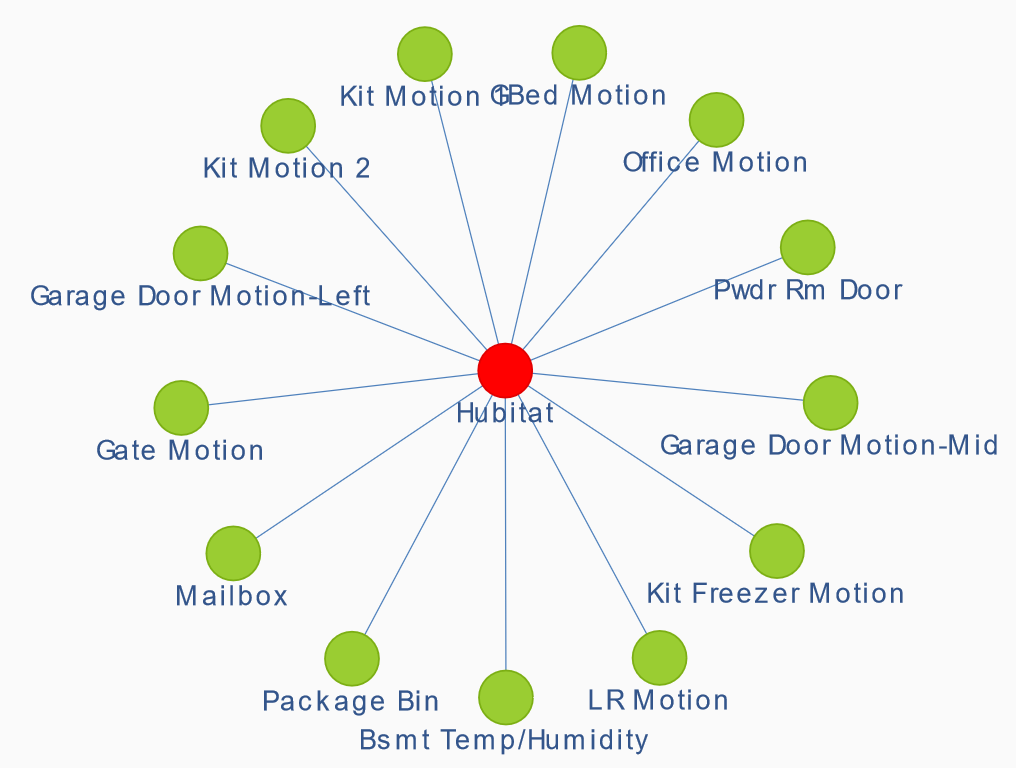

I won't lie. I just started this on one of my device hubs, and simply watched, fascinated as it built the node map. I began thinking i should record a video so i can watch it over! Then, I thought it would be awesome to see it floating in 3d like a Solar system model. Then...well, I decided perhaps the Tequila was doing my thinking.
But, Tequila or not, this is still awesome. Thanks @dandanache and @Hubitat_Staff!

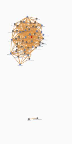

Not sure are we going to add z wave to this topic too but I'll try anyway.
Here's my z wave graph:

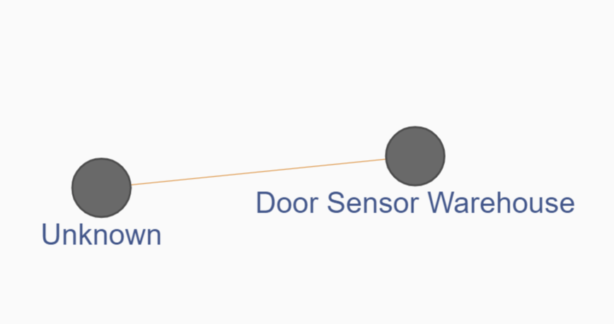

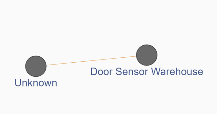

Ad like you see that bottom there:
What's up with these two? I can't find that unknown anywhere. It says it's address 04 but there is no hits on the list. Is it a ghost?
I think the unknown is when there is a device without a router recorded yet. So it attaches to a unknown.
Yes it would work, it was the route I was thinking was missing (disappears after a reboot for a while) but yours in there. Is it still connected to unknown?
