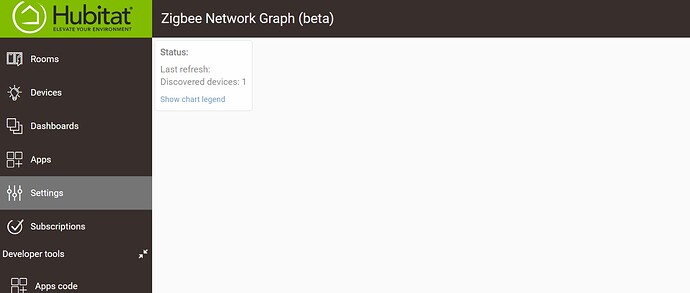

Not sure if I should post this here or not. I did not have this code installed previously, but was very intrigued to see it as part of .145.
This is what I'm seeing on a C7, just updated to .145. Do I need to leave the hub on this page for a longer period to find all the devices?
Yes it is. Still connected and I did new reboot just to be sure.

There is an issue rendering Zigbee graph on C7, C5, and C4 hubs. Same issue affects /hub/zigbee/getChildAndRouteInfo endpoint used by the app. Fix is coming in the next build, to be put out sooner rather than later.

Settings - Zigbee Details. Currently only working on C8.
