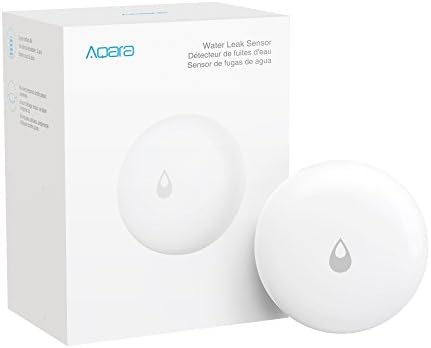

I am going to try one of these and see how they work
You will just take the output of the relay to the two connection on the back May require a little soldering or open of the unit but for 18...i will give it a shot
I purchased 3 of these. I'm still testing the first one (aka its still sitting my desk and haven't had the motivation to put it where it will live)
Anyway the instructions say you can loosen the contacts (which appear to be stainless steel allen head screws) and put wires under the screw heads for remote water sensing contacts. I can't imagine why these would not function when connected to a mechanical / magnetic contact.
Sweet, considering I have 3 of these in boxes in the basement I'll need to give that a shot (never got around to adding them as leak sensors lol)
