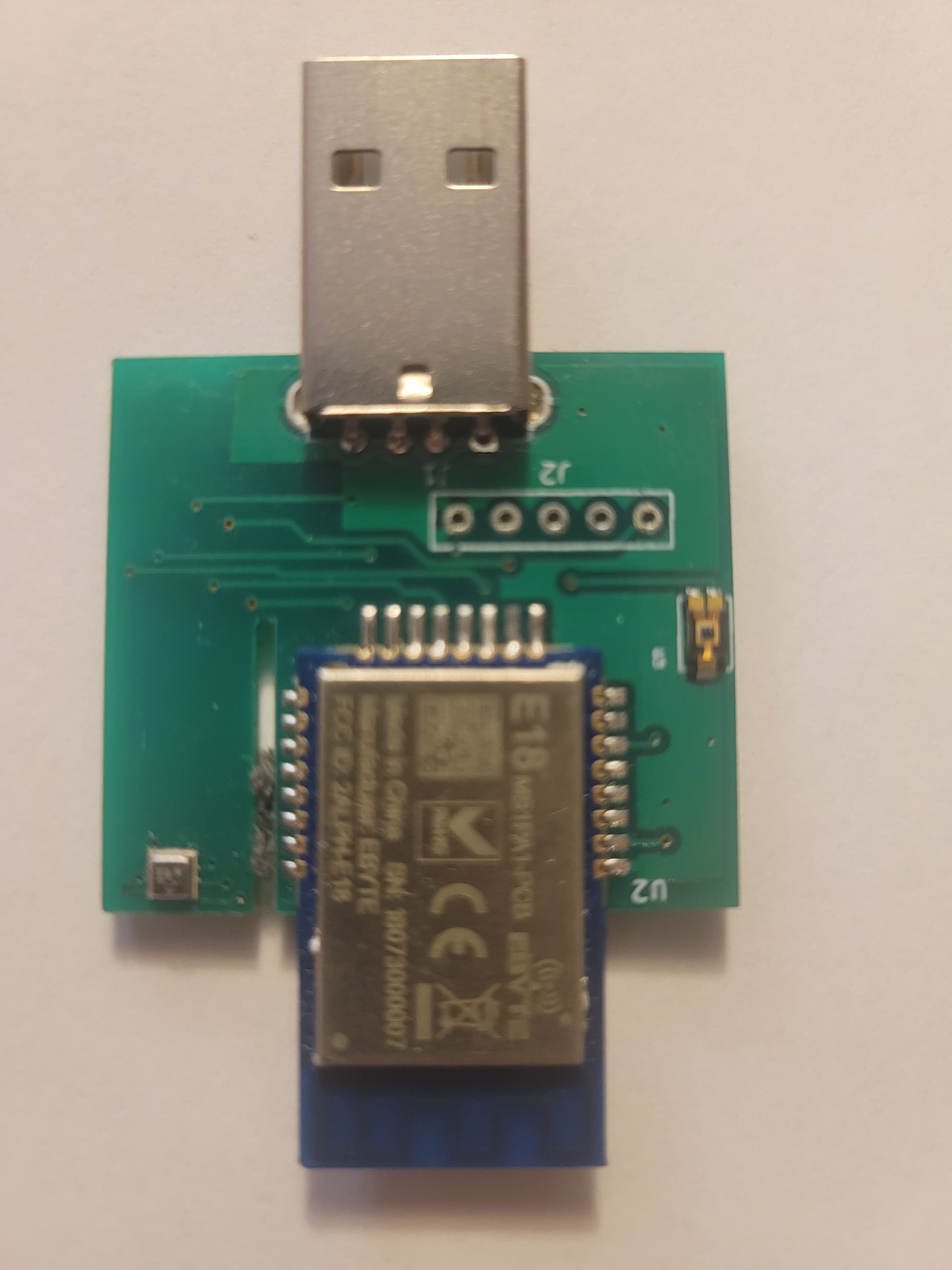

I got couple of those first generation environmental sensors.
@iharyadi is there any way how to turn off repeater function?
It works good as arrival sensor, it just tear mesh multiple times a day.
My understanding is that is basically version of xbee. And with xbee is kind of easy to change firmware.
I am surprised that it worked as arrival sensor. There is not a way to disable the repeater function on this sensor.
