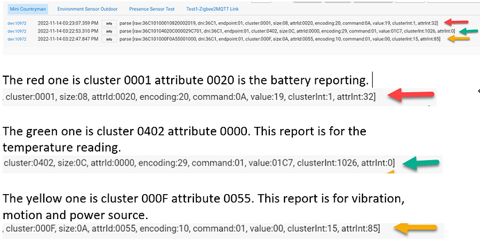

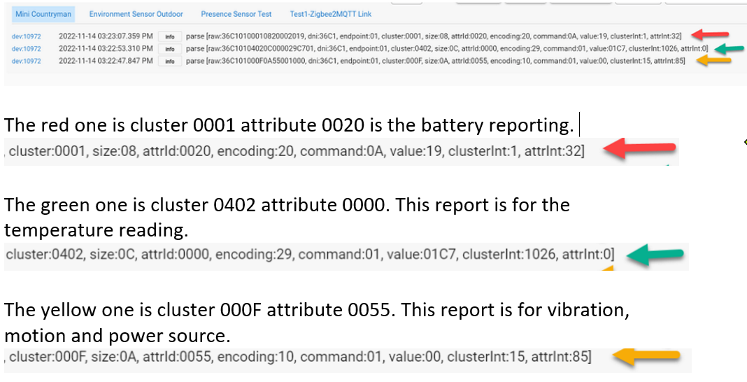

Will the light on the back of the board flash or change at all when in pairing mode?
Been a while since I paired mine, but I don't think it does...more info on pairing to ensure it fully pairs:
- After successful pairing, states should be:
- If missing any of the states can try re-pairing. If that doesn't work:
	○ Assign "Device" driver
	○ Hit Configure button in driver commands and then delete all states/status
	○ Re-assign correct driver
	○ Refresh
	○ Unplug sensor, plug back in, presence should populate and then powerSource and others fill in
	○ I tapped the sensor repeatedly to trigger shock, that seemed to help?
