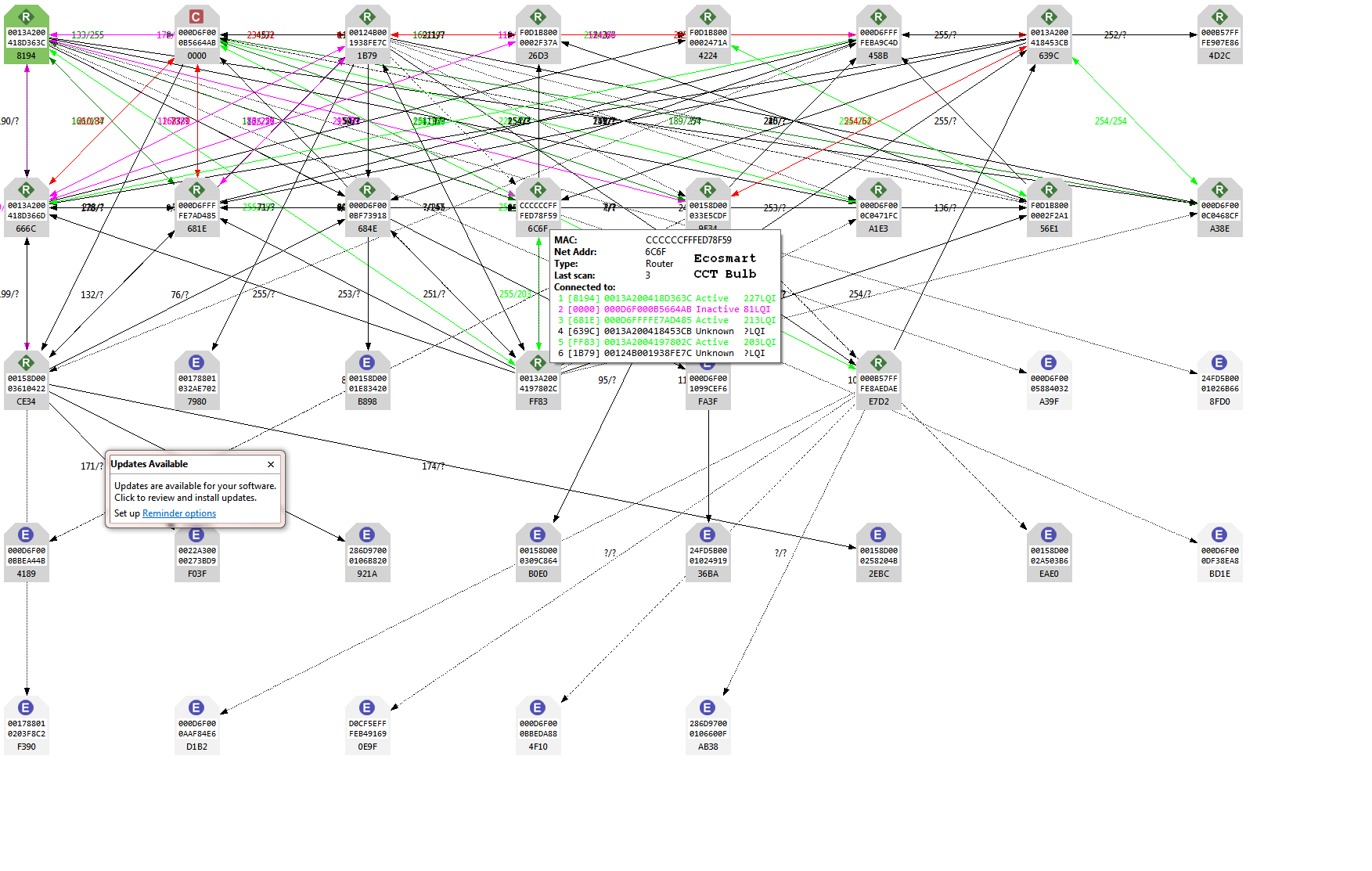

According to my XBEE scan it is a repeater, XCTU shows good LQI. I hope the buffer isn't garbage
