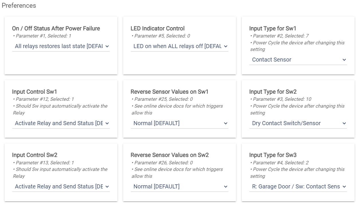

Here's my driver setup... Since I use my S1 - GD Closed reed sensor as my contact sensor in the Zooz Garage Door app, I highlighted the S1 setup options -- you should be using those same options for your reed sensor.
I also indicated a few other things to confirm in the driver... Like the very first option -- I highly recommend using the "All relays Off" option there to prevent door opening after a power loss/restore. My setting's unique due to how I'm using the other relays, but note that I still have my opener relay (R3) set to "Off" there.
Toward the bottom, I indicated a setting in Red --it's the "Child Cleanup" one Jeff alluded to above. You should check that box. Mine's unchecked since I'm using all 3 Rs and all 3 Ss, but most people don't use all of them. Turning that option "On" will help keep the driver cleaner to work with.

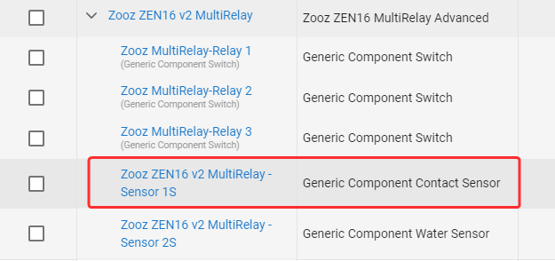

You did not show the devices from the devices list as requested. I need to see if the child device was created correctly (which it probably is not).

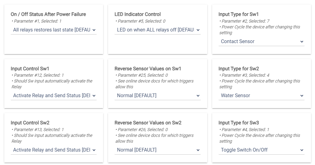

If you are only connecting to ONE GD and one sensor, then you could possibly just use SW2 for the sensor if you wanted. In this example I am showing how to use the R1 and SW1 for the same GD. None of the other R/SW are configured, just left at defaults.
#1 is just recommended, so if power is removed/restore from Z16 there is no chance it opens your garage door. #2 and #12 are the important ones. All other settings are defaults.
You could also use the last option in the Input type which is made specifically for garage doors. I think this will just make the relay be a momentary switch (like pushing a GD button), otherwise the Zooz GD app does this already so I do not think it is required.
Once that is saved and Synced, power cycle the Z16 if you have changed any of the input settings, then turn on the Clean Up Child Sensors at the bottom and save again.
Now, you can check your devices list. You should have 3 Relay childs and One Sensor child that has the Contact driver on it.
With that sensor child there, you can select it in the Zooz GD App.
