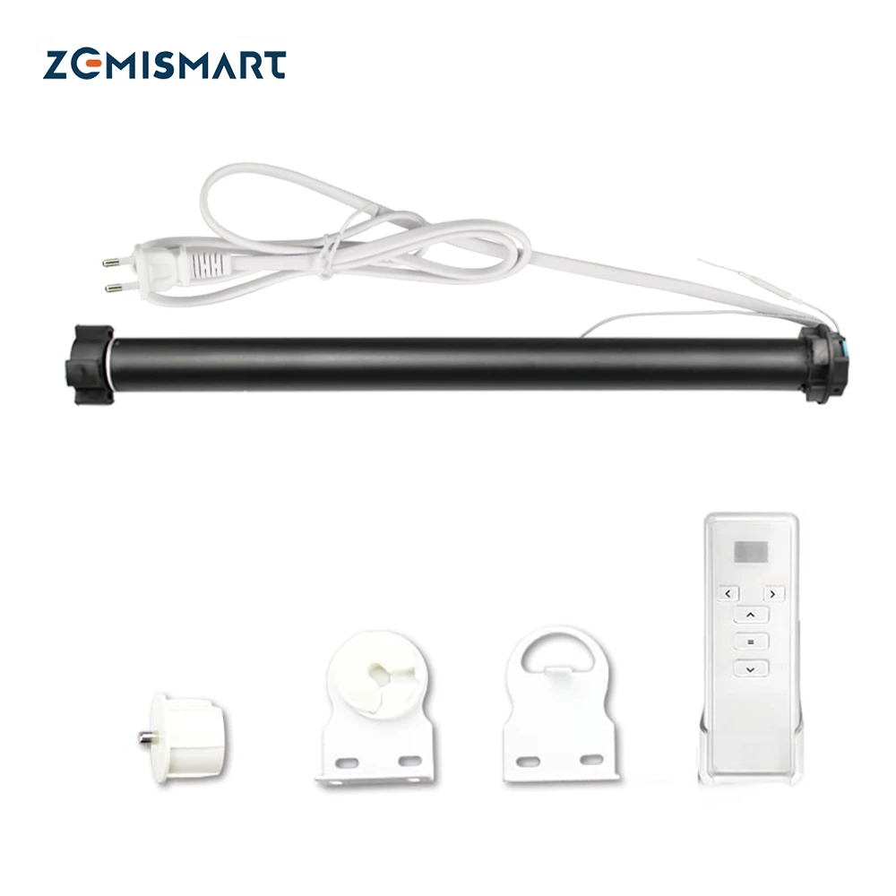

That is unfortunate. Here is the one I bought - it can do percentages.
Hi, Does anyone know if there is a Hubitat version of this Zemismart roller blind driver?
