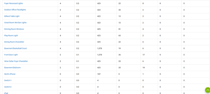

I tried to copy the Z wave details page but I can’t figure how to screen shot such a large page. None of the devices are ghosts. Here is a picture of the graph.

Can you post your z-wave details page in its entirety? Use windows snip
While there are apps that can do this, I'd just do multiple snips.

Here are the snips of some of the past logs and Z wave details. If you look at the oldest log you can see the 3 devices that were spamming with "physical off" signals. 2 of them were dead switches (do not work the lights at all physically or remotely) which I had to force remove. The 3rd one still physically operates.
Sorry for the multiple posts, it will only let me post 5 files at a time.

Someone might be able to tell you something from the details on a Device page for a similar switch, like model, vintage, etc, so you could post a snip of that.
You have 8 ghosts that are probably trashing your mesh. (The ones with the discover buttons next to them) Those need to me removed. Click the refresh button on the device line until the remove button appears and click remove (may take a few times per device). IF you cannot remove the devices you will need a z-wave stick to remove them. Your z-wave radio is likely working fine, it's your mesh that's trashed.
