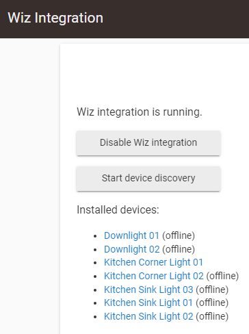

I am following up on a bug that I reported earlier in 2022. I have 7 Wiz bulbs which have been operating fine. However, their status in the integration app and device page randomly show as offline, even though they are actually online and fully controllable via Hubitat and the Wiz v2 Android app. They all have their own DHCP reservations.
I find it strange that their status changes randomly, with no apparent pattern. I can check them throughout the day and they will change back and forth, but they will always be operational. It's not negatively affecting me, just wondering if anyone else experiences this...
I haven't checked this in so long as they just work. That said i just checked it and most of mine are showing offline as well.

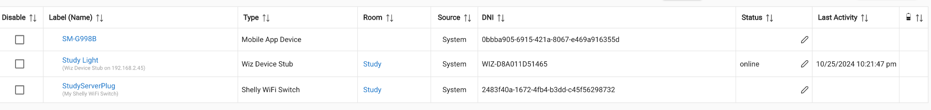

Wiz light that I'm trying to control: 192.168.2.45
is showing up in the devices correctly.

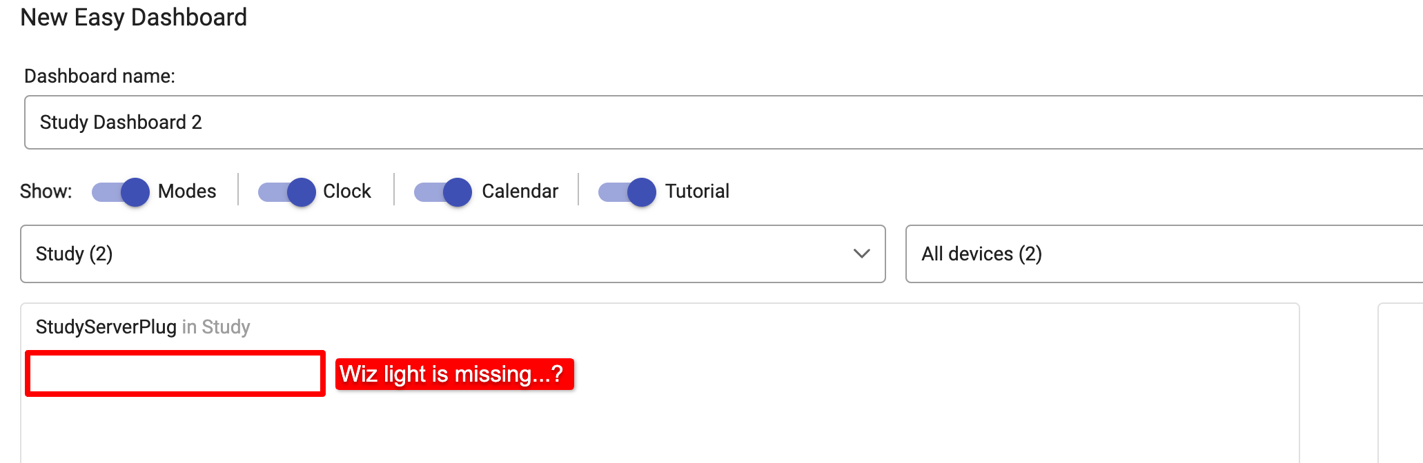

I cannot create an EZ dashboard with the Wiz light, because, as shown the Study Light is simply not present in the list to move into the right column.

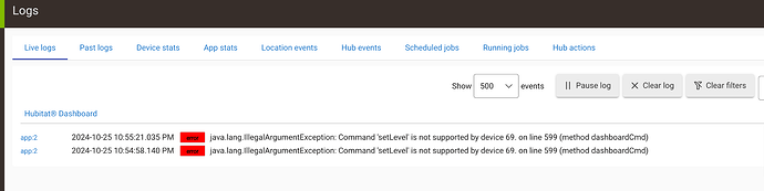

When I check the live log for this dashboard get this:
Does Hubitat just not support Wiz lights?
