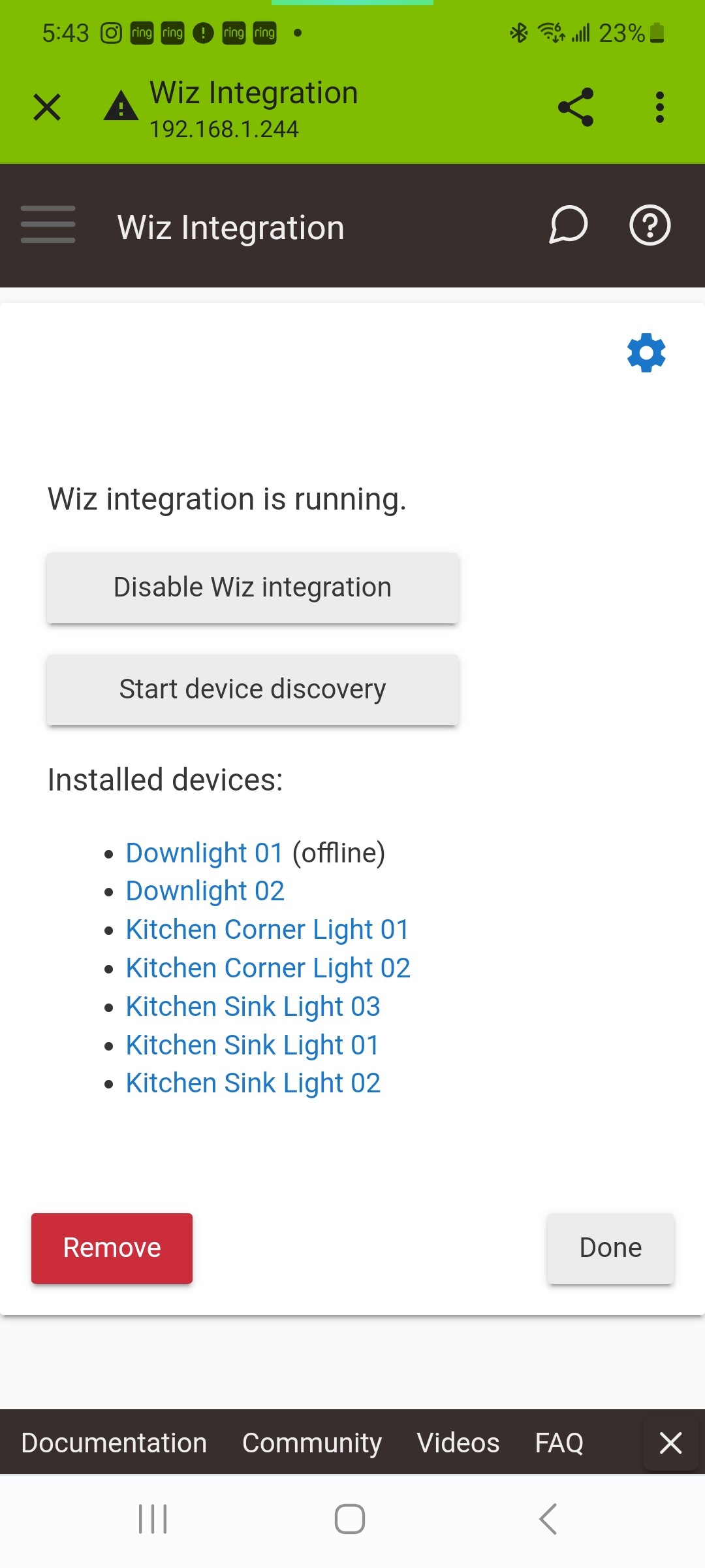

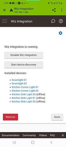

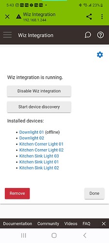

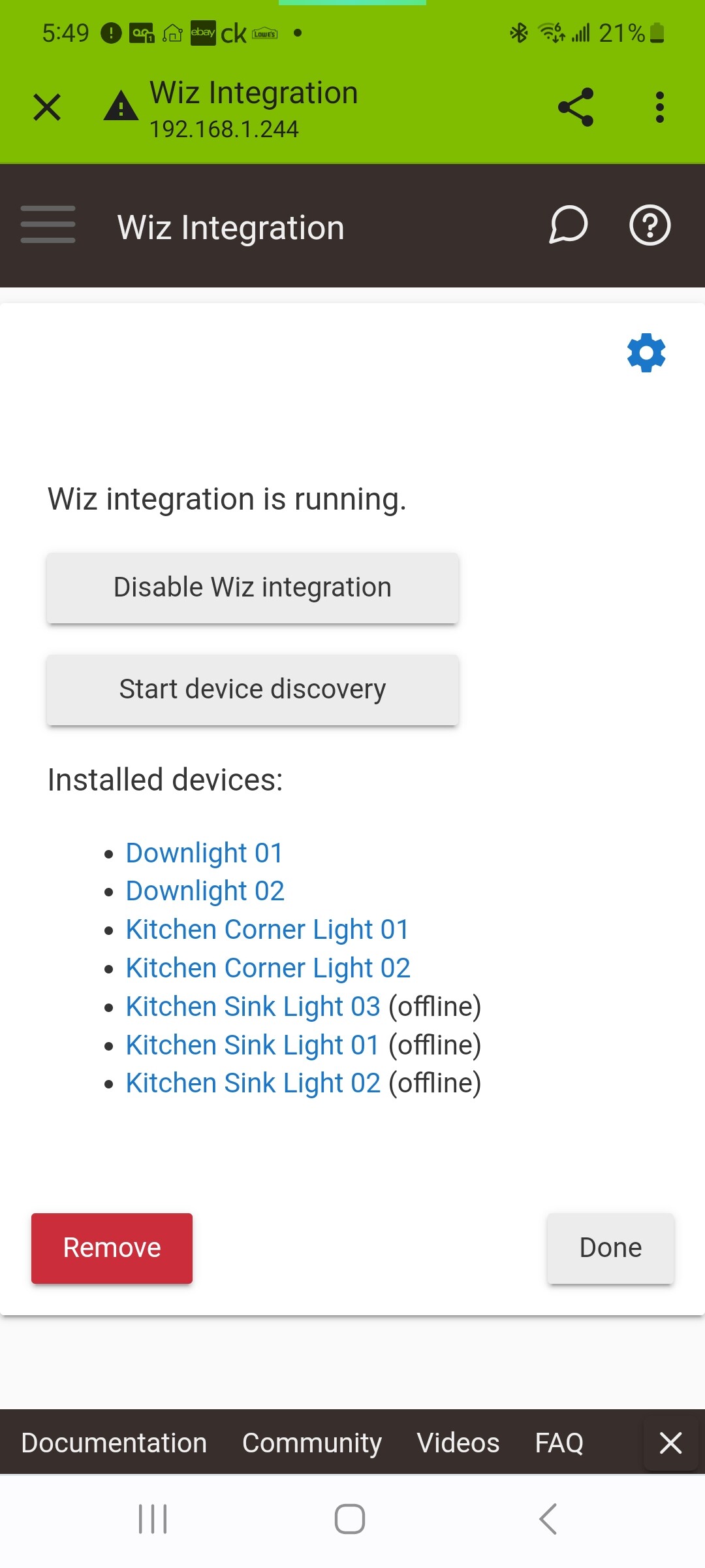

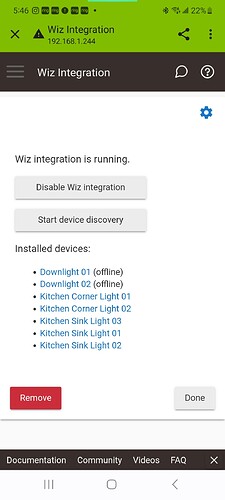

I just migrated to C8 hub. Everything went smooth. Only issue so far is that my wiz lights shows offline. Oddly not all of them. The ones offline are still controllable via hubitat commands. And if re-run discovery in the app integration, some devices switch online and the others become offline or stay offline.
Hub is still on lan connection in same location. Just swapped. Only thing that changed is the hub and the IP my router assigned to the hub is different from previous hub.
Any ideas to troubleshoot? @gopher.ny
I've attached to back to back discoveries showing how they switch between offline and online.

Devices going on/off generally means that regular updates from those devices don't reach the hub. I'll relax the timing on a bit in the next build, hopefully that solves it.

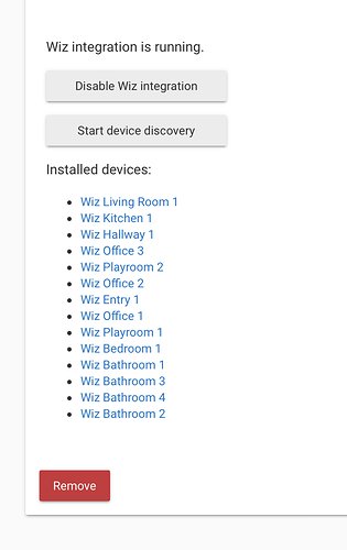

I'll chime in here as well. I have not had a C7, C8 was my first so I have not done any migration. Setting up as new. The app/driver discovers the bulb fine, and I'm able to rename it and all that. I have them on the same circuit as a Zooz Zen72 smart switch which are in smart bulb mode, I've created a group for each room and a Basic Button Controller thing with just 2 commands, up to turn on group, off to turn off group. It works in one room, but doesn't in the other 2 rooms. Same issue here, some bulbs in the integration app showing as offline despite them all being on and controllable with both Hubitat commands and through the Wiz app. I am on the latest Hubitat software as of 3/27/23 at 19:00EST. The whole reason I decided to upgrade from my dumb switches was in an attempt to prevent killing power to the Wiz bulbs so that they always kept track of where in the Rhythm they were supposed to be and I wouldn't have to manually re-enable the Rhythm when turning the switch on in the morning. Thus far even just this one concept hasn't worked, which has been a huge bummer. Hoping something can work out :slight_smile:
Which now I see where it states the platform version. I'm on 2.3.5.118

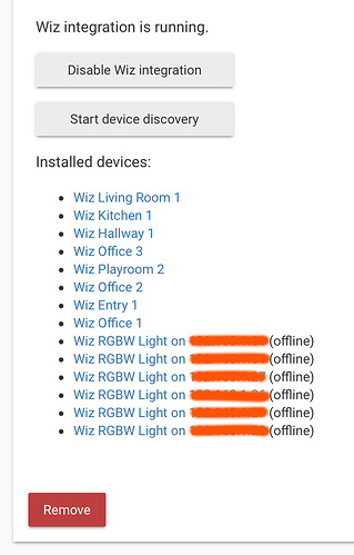

Another quick update. Any lights showing in the Wiz Integration app page that were showing as (offline) I removed/deleted, waited for them to automatically show up again, went in to their settings and renamed and assigned the Type and the room and all that, did that for every one and for awhile it was remaining while I was experimenting with other things I'm working on. I rebooted the hub eventually, and it "forgot" some of my Wiz bulbs (evidence: it forgot the specific names I had assigned individual bulbs, and upon clicking in to the device it had also forgotten the room which they were previously assigned) so I'm having to re-do all that pretty frequently and they're again showing as offline.
Are you sure those last 6 aren't on another server using Hub Mesh? (that's what the verbiage looks like)
I'm positive. This is what it looks like after the Wiz Integration app has its brain fart and just forgets stuff. I have gone through this extensively, noted IP addresses and MAC addresses, confirmed that the bulbs ARE on the network via Alexa control and effective control through the Wiz iOS app.
When I get done deleting/readding it looks like this for awhile, then some time later it just decides to pout and forget things.
Okay, looking closer I can see the redacted values are IP addresses, thought they were hub names. Haven't played with this integration so just spit-balling here, but is it possible that these bulbs are having issues staying connected to the LAN that are not related to power, i.e. low WiFi signal strength, RF interference, etc.

I painted over the IP addresses because I'm ignorant to whether someone out in the interwebs could/could not try to do something malicious with it, so I crossed it out to be safe. And to answer your question no it definitely isn't a LAN or wifi issue. Though the Hubitat/Wiz Integration app says they are offline, the bulbs themselves always retain their connectivity and functionality, verified by Alexa commands to bulbs still working as well as the Wiz iOS app always retaining full connection to and control over the bulbs. I've checked in the router itself to see if its doing something funky with reassigning IP addresses or something and its not, they remain consistent. I'm on Hubitat version 2.3.5.118. I have not yet been specific enough to notice if its the SAME physical bulbs that end up getting forgotten by HE, or if theres any pattern at all to that, but I do at least know the bulbs themselves have good connectivity to the network and functionality. Either Hubitat or the Wiz Integration app itself (I'm not sure of the innerworkings of all that) seems to be where the disconnect arises.
