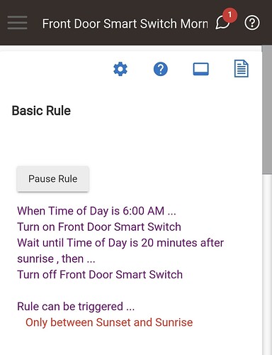

I do indeed have another basic rule with the same device that does have restrictions. Do the rules somehow interact with each other? One is set to control the switch in the morning (with restrictions), and this one handles nighttime. Do I need to use Rule machine instead of basic rules?
Other rule on same device for reference:

That was also my thread, and my understanding was that specific bug was related to the time of day constraints. I've already upgraded to the newest release that included that bug fix, and that issue is resolved - this is a separate one apparently.
