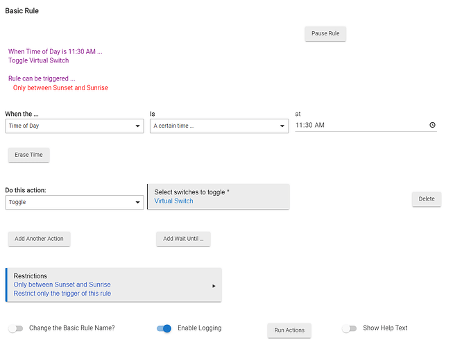

I just created a test rule, which is currently saying it is restricted, we will see what happens in 15 minutes.
When Time of Day is 11:30 AM ...
Toggle Virtual Switch
Rule can be triggered ...
   Only between Sunset and Sunrise
You have it set so that the rule and pending actions can ONLY run between Sunset and Sunrise yet you are trying to turn off the switch 20 mins AFTER sunrise.
From this I'm assuming the light will never turn off.
Yeah I covered that with them on Reddit, but even with that setting changed the trigger still fires.
This is clearly looks like a bug, I was able to replicate it. @bravenel is this your app?

In their case sometimes 6AM is AFTER sunrise, and it is still triggering the light to come on. As I showed above I was able to replicate the issue with a similar rule.
I can confirm there is a bug with the restrictions in this case. It manifests when the option to restrict only the trigger is selected for the Restriction. A fix for this will be in the next release.
