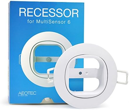

https://www.amazon.com/Aeotec-Multisensor-temperature-humidity-vibration/dp/B0151Z8ZQY/ref=sr_1_12?dchild=1&keywords=Aeotec+wall+mount&qid=1603305874&s=hi&sr=1-12
There’s a mount that lets you recess The sensor for a more flush look
