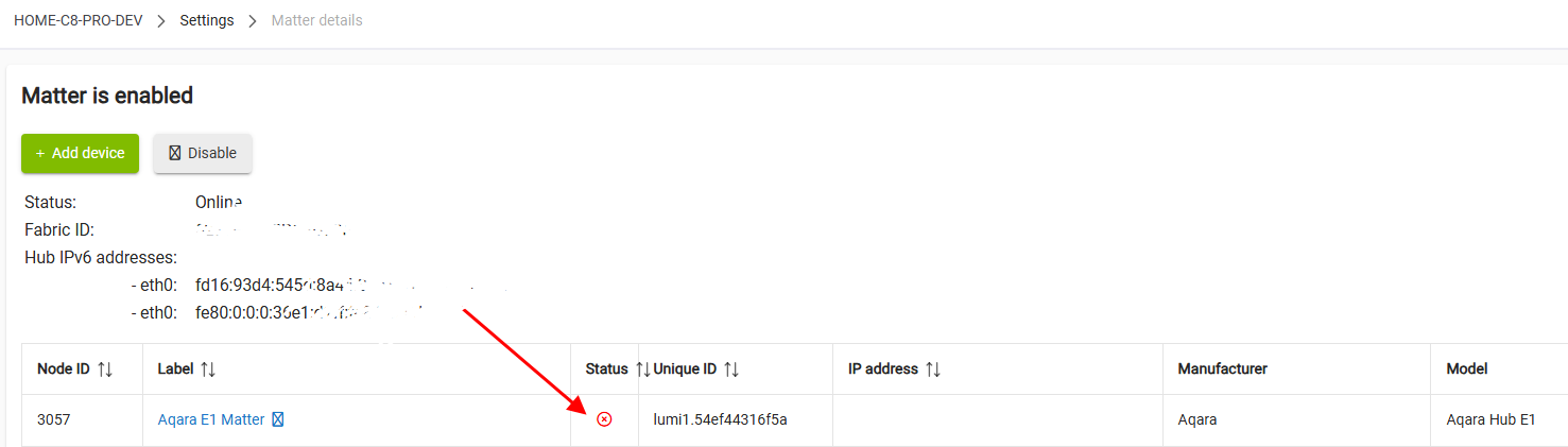

It seems that the connection from HE to the Matter device has been interrupted for some reason. In the logs, do you see re-subscription attempts every 10 minutes? (this seems to be a HE Matter new functionality?).
Check Settings -> Matter details : is the status of the device OFFLINE ?
Do you have any mains-powered Matter over Thread devices nearby the sensor to act as Thread routers (repeaters) ?
Nothing in the logs.
Yes.
It is now working again. Don't know why, just started working.
I don't have any Mains powered Matter over Thread devices that I am aware of. The unit is close to a couple different Apple Hubs. I have several Mains powered Matter devices but not sure if that qualifies.
I hope there will be improvements in the reliability of Matter devices handling in HE in the future platform updates. It's essential for me to know whether a sensor is online or offline. This is especially true for the IKEA Thread water leak sensors; we need to be completely certain that the device is online and will send an alert when a leak is detected.
I put the sensor on that closet to replace an old IRIS sensor. The application is non critical so figured it would be a good test.
Wondering why I don’t see any resubscription messages if HE is supposedly doing that. Especially since I have had other devices drop off occasionally.
The Matter details still shows offline even tho it is working.
