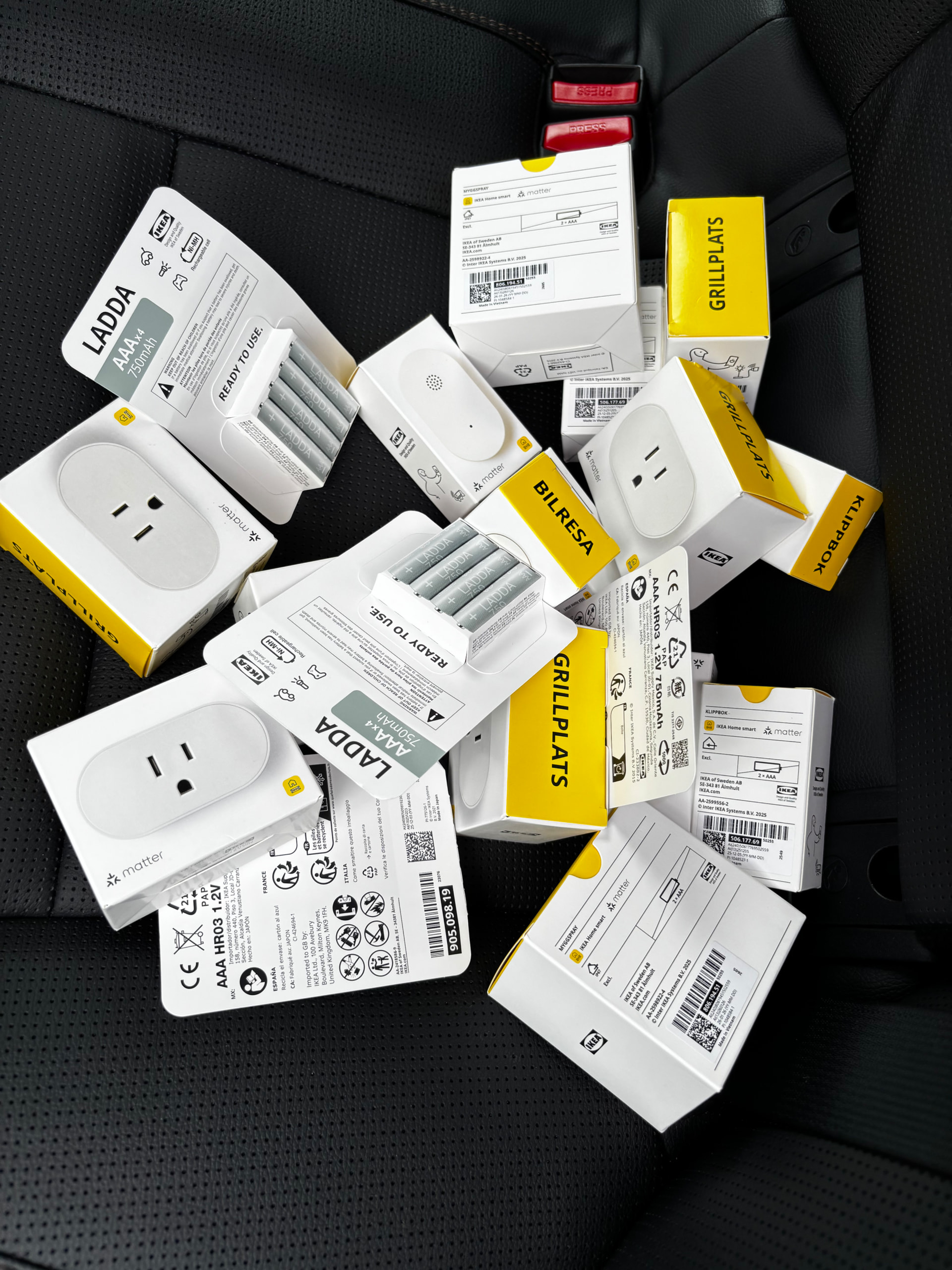

My IKEA devices have been much improved since adding several GRILLPLATS plugs throughout the house. Firmware upgrades may have also helped a lot.
That shouldn’t be enough to make me go nuts at IKEA but here we are.
