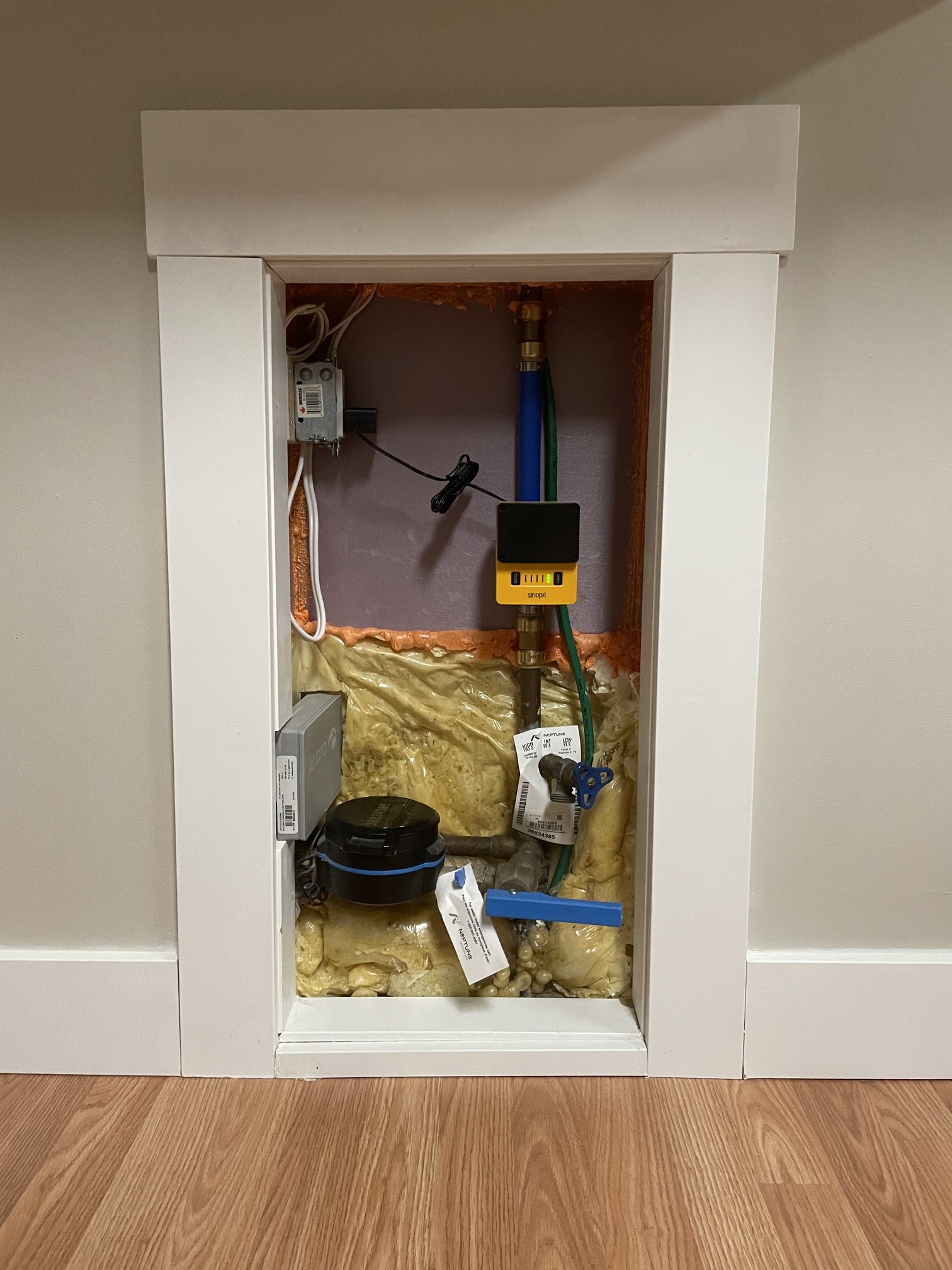

To me it looks like it's soldered but I'm not a plumber!
It is a 1 in. soldered ball valve, manufactured by Watts which is a good brand.

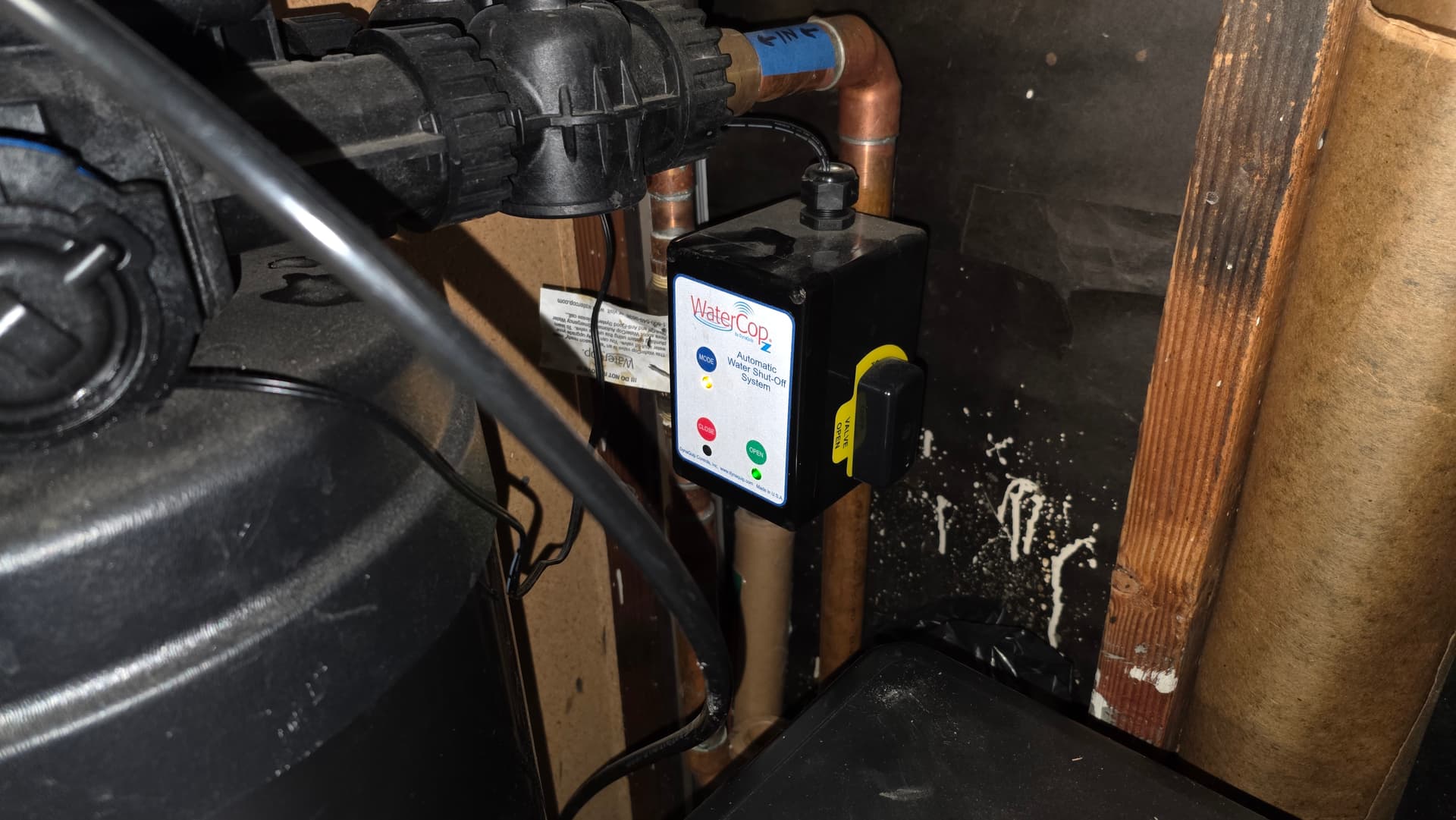

I do. :slightly_smiling_face: It's mounted next to the water softener. A bit odd, but we actually have two shutoff valves. Original is in the pics above, the other is the WaterCop next to water softener, pics below. It's downstream from the original shutoff valve.
Wife wanted WaterCop in an accessible location, hard to get to the original shutoff valve, so we ended up really only using the WaterCop.
The Bulldog's control unit is connected via a wire from the motor, so I can mount the controller where she will be able to see and reach it, so I'm putting the bulldog on the original shutoff valve. :slightly_smiling_face:
Thanks for confirming! Should be an easy install (in theory). :wink:

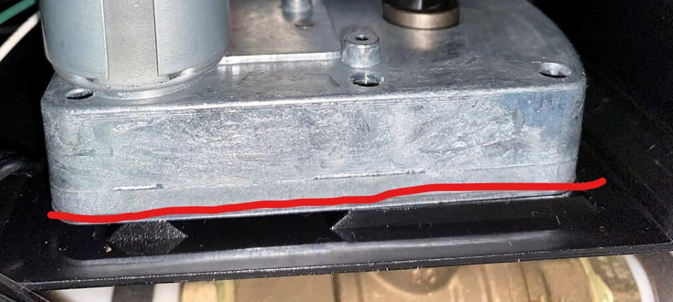

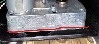

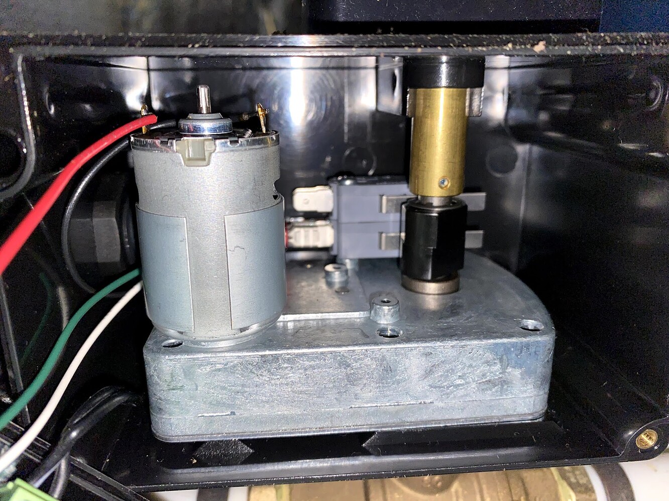

Maybe see if you can repair it, since it's on it's way out anyhow.
Pull it off the valve to have a play.
Not many screws to get to the gearbox. :thinking:
Change the grease and see what happens. :person_shrugging:
Interesting... Where would the grease go, exactly?
Well...
I've never played with that exact device, but if the joint on the bottom of the case is an easily removed plate, then the exposed cavity will likely be the gears and the grease in question.
But then I'm probably more willing to have you destroy your stuff than you are. :laughing:
LOL... I've destroyed enough stuff "fixing" them over the years.
In addition to a reliable controller, I want battery backup and direct wired sensor, and since I wouldn't know enough about it to tell if my attempted fix was a solid fix, I think it's time to retire the cop, give him a donut and gold watch and move on to the young dog. :wink:

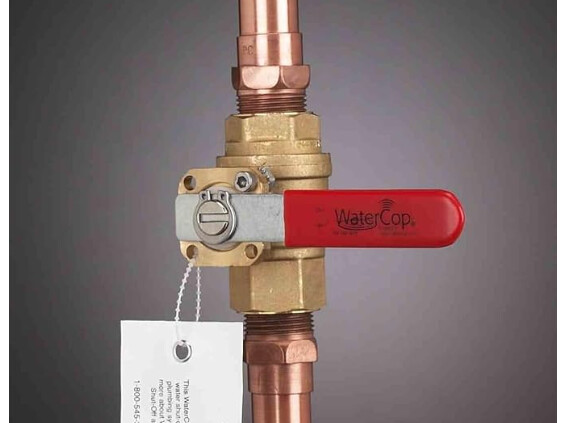

From this rough in listing it looks like you should be able to remove the actuator, install a handle and use the water cop valve with your new water sentry of choice at that same location.
Oh, that is good to know. I might take that opportunity and put it there since it is easier than to see/access both the main actuator and the controller.
