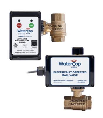

Ideally, I'd like to replace the actuator with a rough-in lever, but I've been searching and cannot find it for sale separately from the valve. I guess I'd could just toss the valve part but that's about $55 wasted. I did leave a message on the WaterCop site and will post what they respond with. ChatGPT said I could use a fork coupler and a generic handle, but the coupler's connection is the wrong sex. It is also a female as is the WaterCop supplied valve.
For any that don't have a WaterCop and wonder what the valve looks like, here ...
watercopvalve side view

Of course. I probably assumed your box image of the valve was your valve and it wasn't installed.
