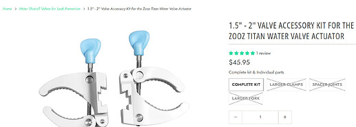

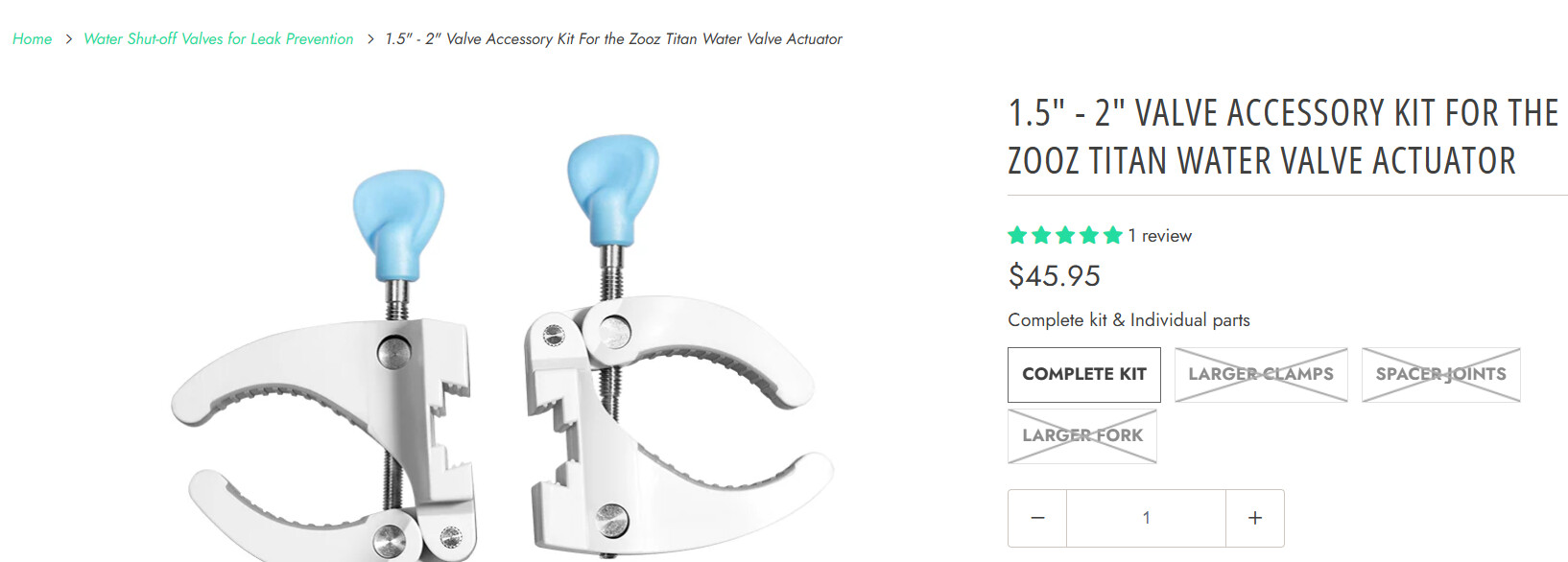

I'm in the same boat. I've got a 2 inch valve so my options are limited. Check out EcoNet. They have both Z-Wave and Matter over WiFi options.

Regarding this...
The Zooz Titan has a converter set for larger pipes/valves...

I'm also on the 700 series Titan. My valve/meter setup situation is complicated: I have two 1/4 turn shutoffs, one on each size for the water meter... plus the Water Co's plastic oversized 'lock outs" on the couplings on each side of those valces connecting to the meter (to prevent any mischief). The titan's clamp adjustments (maxed out) fit in one and only one configuration, on one of the valves in this setup; but worked through calibration, and no issues since,
