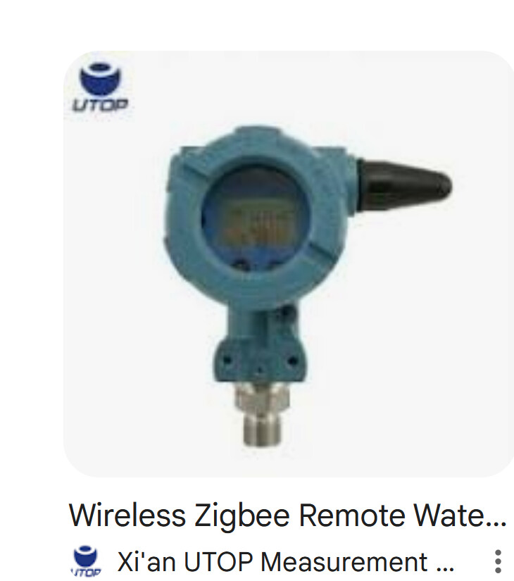

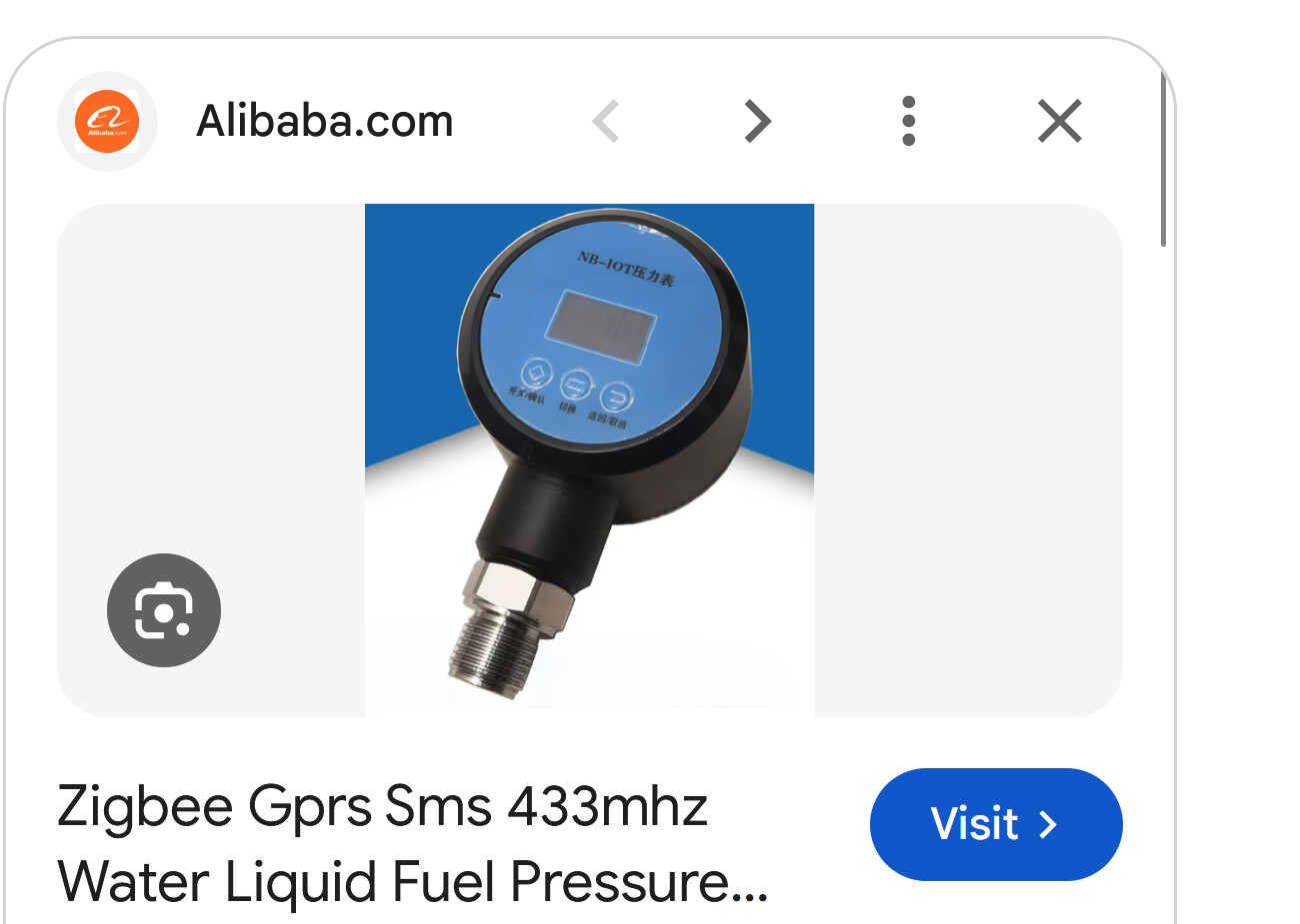

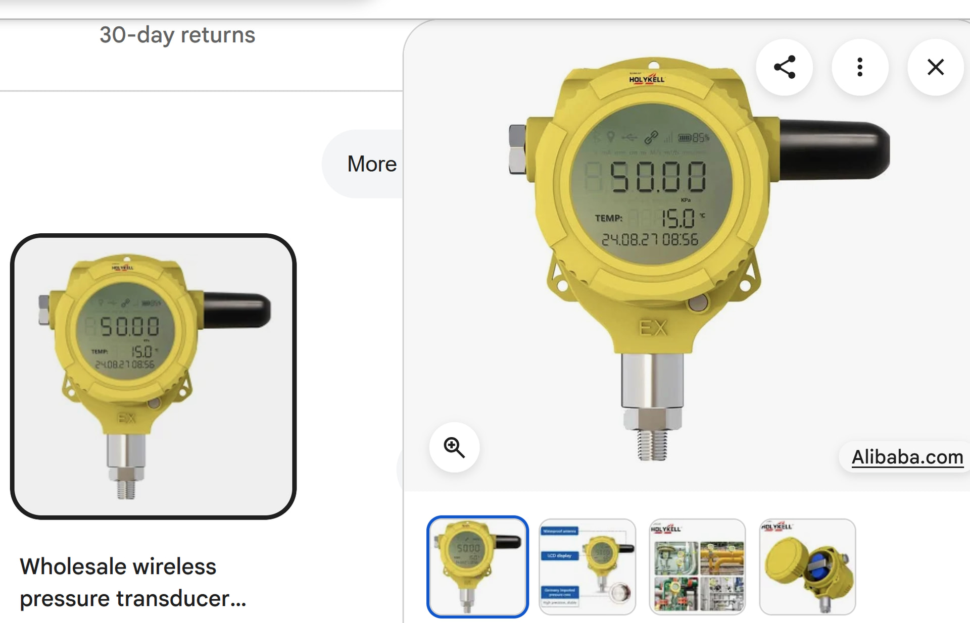

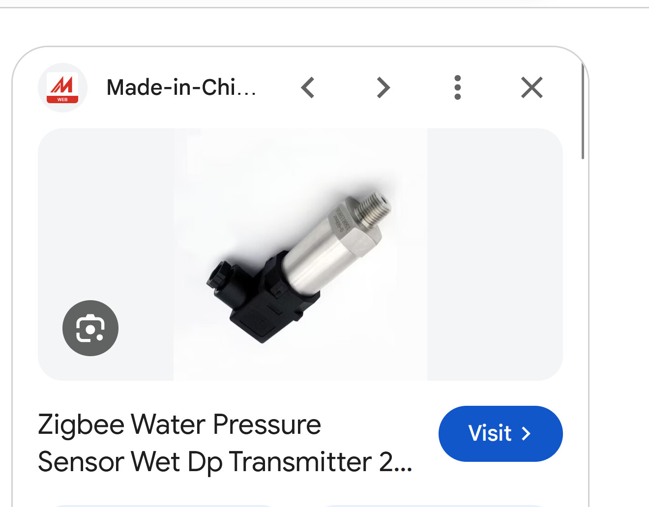

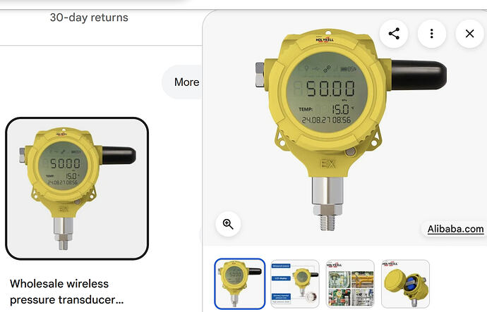

just google zigbee water pressure and lots of them show up. Lots on alibaba and what not
I just did this and nothing comes up but garbage as any other Google search, water valves, water flow, WiFi stuff, thermostats, etc. Ho and of course a bunch of DIY, any links to what you saw that are actual Zigbee water pressure sensors?

@rlithgow1 , have you even clicked any of those, the 3 I found those pictures on Alibaba are not even Zigbee at all but industrial 4-20mA units, they are not even in the realm of DIY friendly ADC signals.
I have worked with these kind of units and they are rugged harsh environment units used in industrial applications (prices also reflects this).
