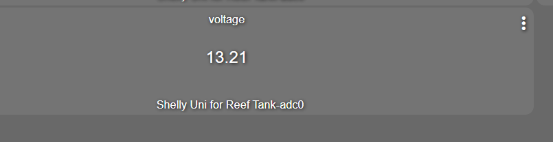

Also, for anyone trying to add a Shelly Uni tile with Voltage, I had to pick the "Attribute" Template and then select Voltage from the Pick an Attribute pull-down.

I could add UNI to Hubitat by following your instructions.
it gave me voltage measurment on the Tile same like Shelly app.
what iam looking for now is how to make a tank animation Tile on Hubitat to be friendly user for my familly to see tank level without calculating the Uni Volts.
if you reach any idea please share.
