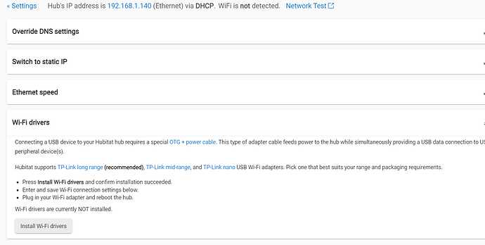

Hi, I tried to to install driver like in this explanation,
but after i got notified that installation i successful,there is NO menu to write the credentials for wifi like it appears in attached image.
What do you see instead? Or where are you trying to open to enter the password?
it should open space where i should enter wifi password,but after the installaton,notifies me that it was successful and that what i see(attached image),
there is no place to enter the wifif password and network name.
It mentions the drivers are not installed. Have you tried refreshing the page? Do you see anything in the Logs page?
after installation i see message that it is installed ,please look in new attached image
nothing in the log,another attached image

i think the problem is that driver not really installed.
even after notification that driver installed,i can see that driver not installled

i bought supported dongle,the problem happens before even before inserting the dongle.
Driver not installing,i got notification that installed but it is not installed.

tried it now,it is the same,blue circle rotates like it is installing,but at the end even after notification it is installed ,it is still written on the page that it is not installed and no place to enter network id and password,like in attached image .
